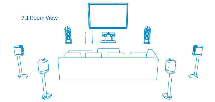

I just built a 7.1 system with these Pioneer speakers plus an SVS PB-1000 sub powered by a Marantz 5007. I'm still playing with angles, crossover settings etc, but they sound really good to me so far.
I believe that if I'm using a sub, I should cross the the center, sides, surrounds etc over at 80 and let the sub do the rest. Currently I have the 4 bookshelf speakers in the 4 corners of my room with the sub at 3 o'clock relative to the TV, with towers a few inches on either side of the TV. The receiver automatically set the crossovers to 40 for the bookshelves and 60 for the towers after running the auto-calibration.
Anyone have suggestions for me? Placement, crossovers, anything...

Lets see a pic of your setup and we'll go from there. For DTS and most setups Fronts 80, center 80, surrounds 60 or 80, sub LFE

Here you go. Not sure how to re-size them. Like I said, I only got this together about a week ago. I still need to move my pc desk over a bit. Not sure what to do about the lamps. I may have to move the one from between the couch and lazy boy so I can have the back speakers facing each other. I'd rather not move the couch up for rear placement, but I'm up for suggestions if it would really make them sound that much better. Also, the satellites at 10:30/1:30, I'm wondering if I need to move them to 9:00/3:00.
Thanks for the help!

Thanks! I'll check that out.
I have an svs pb-1000. At the 3:00 position currently. In between the couch and lamp.
