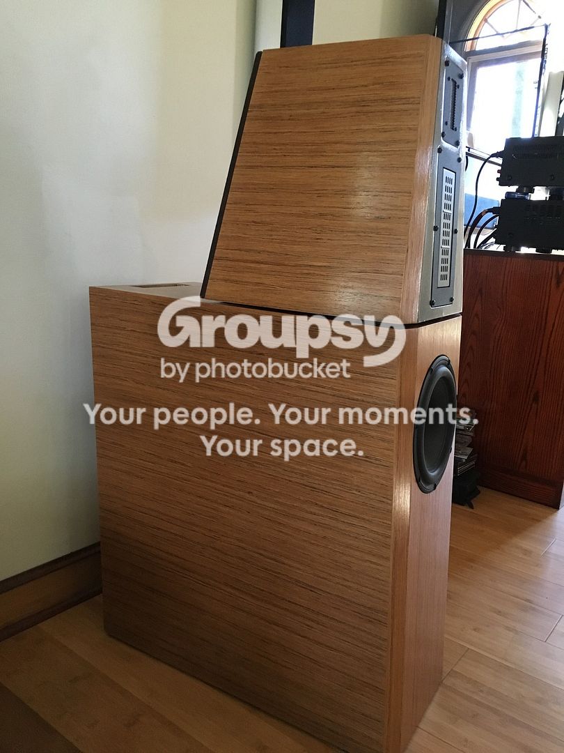

    [​IMG]

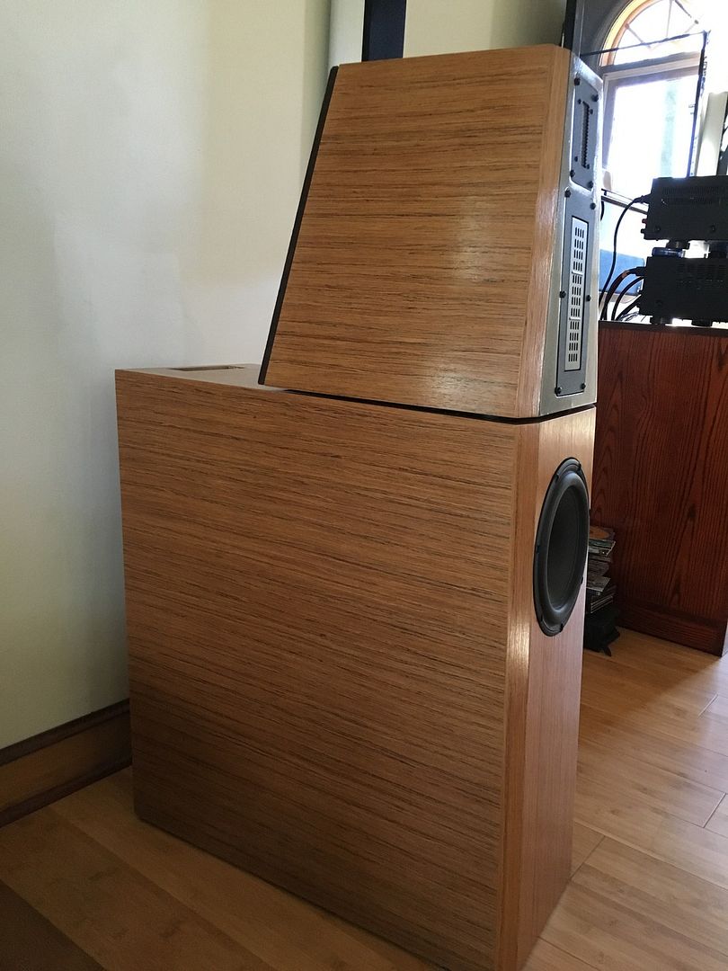

    Genius is said to be 1% Inspiration, and 99% Perspiration. Philharmonic Audio's inception and duration within a demanding market place offers proof that a Teacher, turned award-winning DIY enthusiast, turned Consultant and Designer for brands like Salk Sound, all while being an active Assistant Principal Violinist, can also educate one's ears to 'see' what really comes through the other end of a microphone.
    Dennis Murphy has accomplished this in multiples. Not just with his top-of-the-line Philharmonic 3, but also through a broader range of products including his Affordable Accuracy Monitor that introduces listeners to what quality design, free from over-ruling marketing departments, can produce!

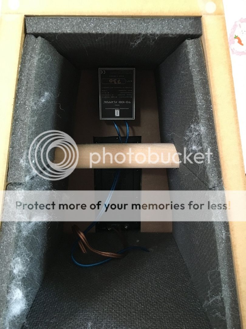

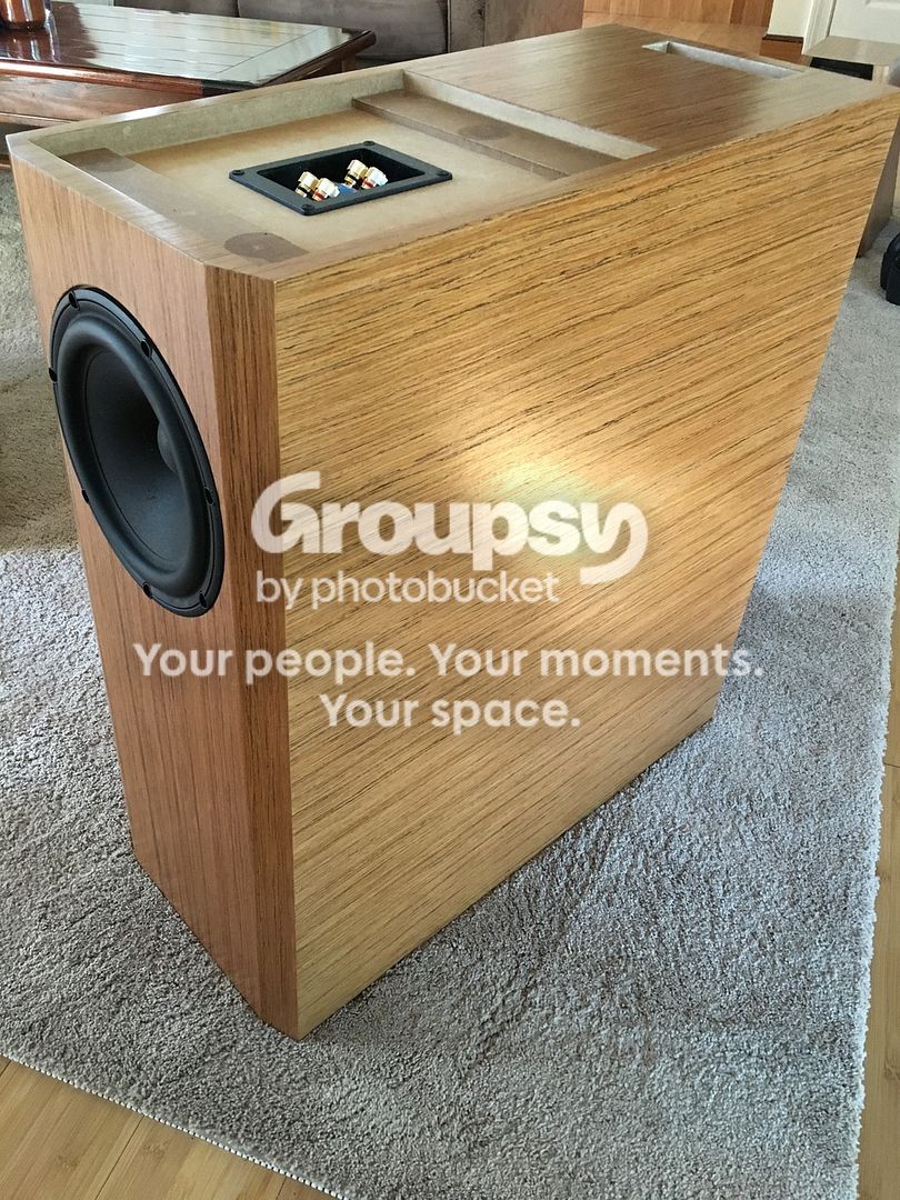

    Upper Cabinet Removed showing the high quality terminals. The 8" Revelator Woofer sits proudly in its slanted transmission line cabinet:

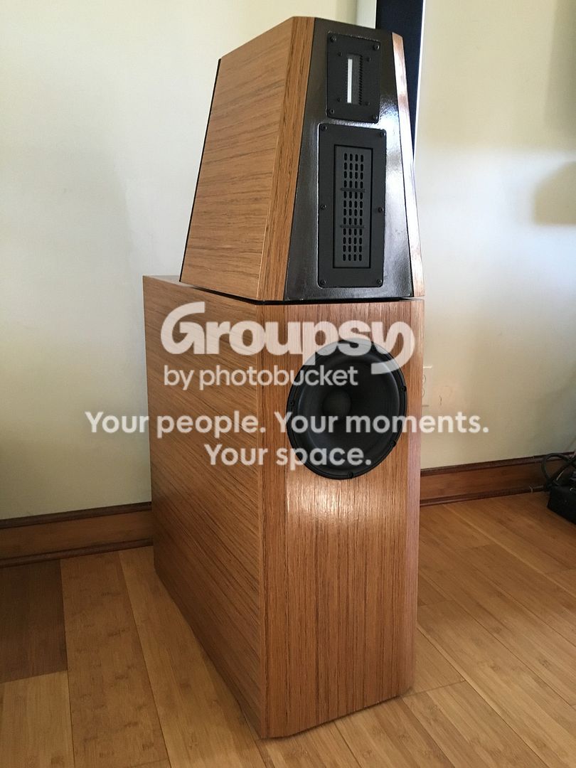

    Overview:
    The Philharmonic 3 is a 3-way floor standing, full range tower speaker that utilizes a RAAL 70-10D ribbon tweeter and BG Neo8 planar midrange mounted in an open-backed enclosure, isolated by sorbothane feet. A ScanSpeak 22W8851T00 8” woofer mounted in a separate Mass-Loaded Transmission Line handles the bass and extends useful output to below 25 Hz. It seems Dennis' innate comprehension of crossover design allowed him to hand pick each of these drivers to compliment one another better than any previous design.
    The extremely flat and wide dispersion of both the ribbon tweeter and planar midrange allow for effortless set up for multiple seating locations. The 8” woofer in transmission line enclosure allows for subwoofer-free listening for all but the most demanding LFE movies. For strictly music listening, the Philharmonic 3 was preferred full-range without a subwoofer.

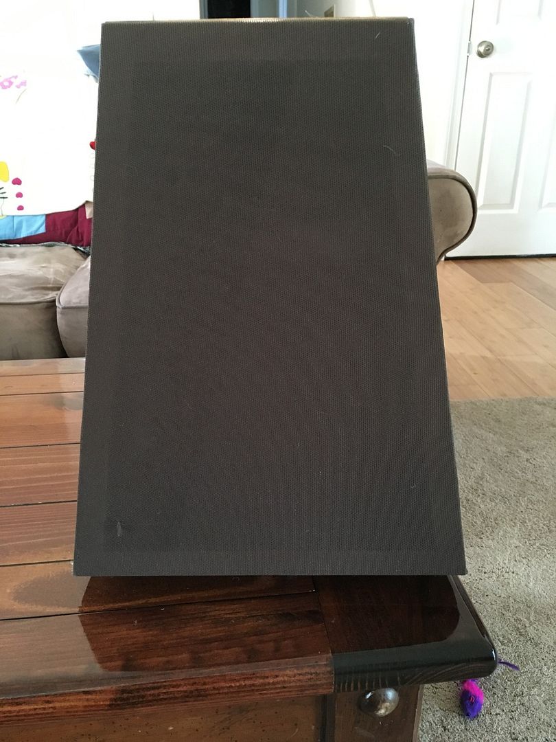

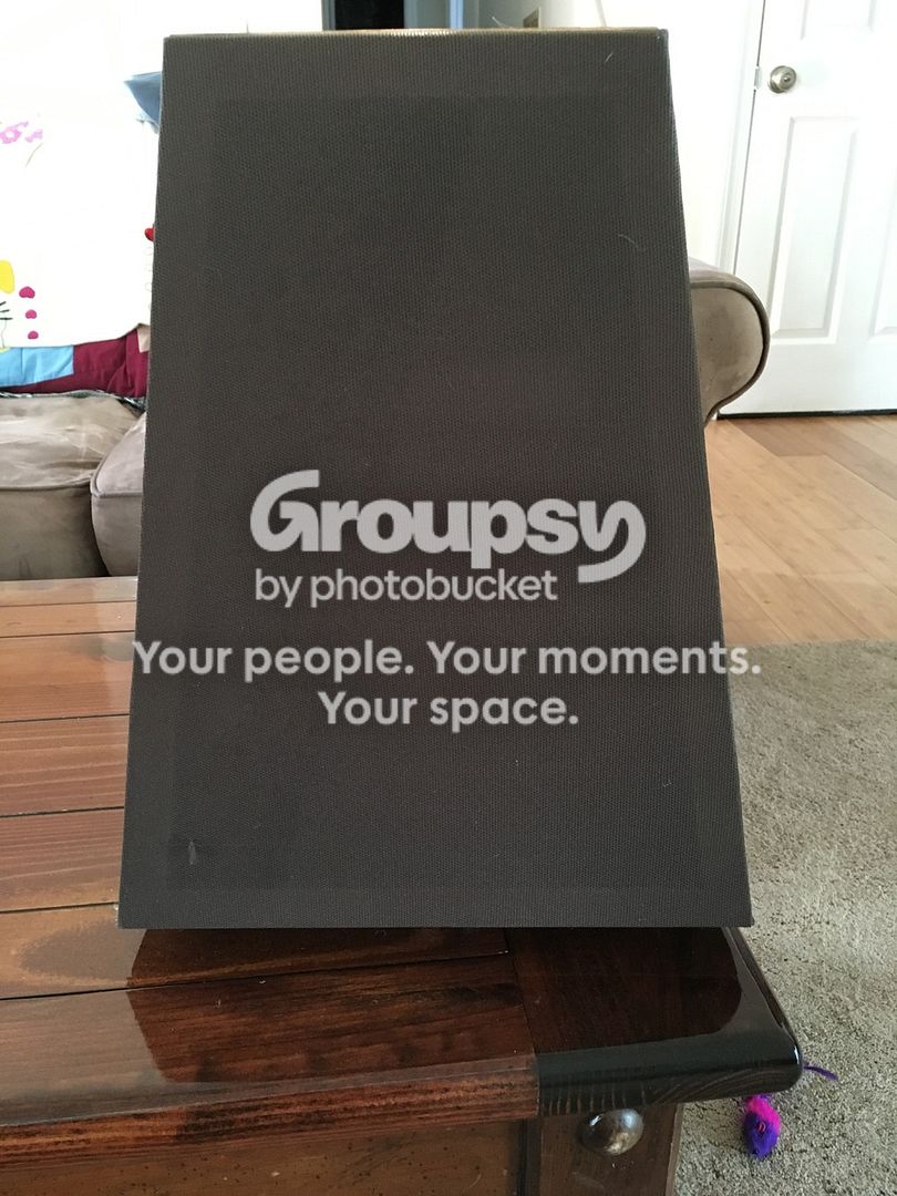

    Rear of Upper Cabinet has a magnetic cloth covering wrapped over a wooden frame:

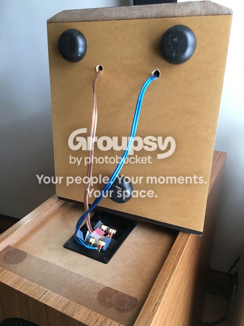

    The cabinet is built as two separate sections. The high sensitivity ribbon tweeter and open back planar midrange need to be isolated from the thunderous vibrations of the Scanspeak 8” woofer. So they are placed in an asymetrical open-back cabinet with which a varying amount of 'absorption fluff' can be used. I chose to leave them completely open. The tweeter also includes small pads to attenuate the ribbon and control dispersion. I found the sound more open and revealing with out the pads.

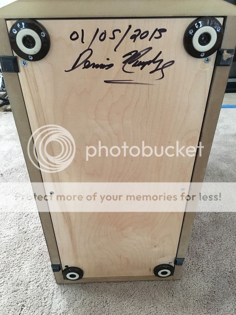

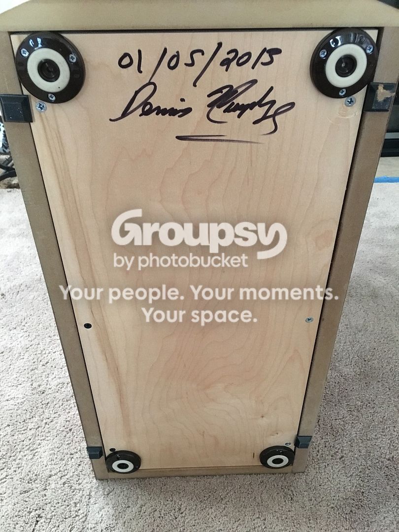

    Under-side of Upper Cabinet:
    [​IMG]

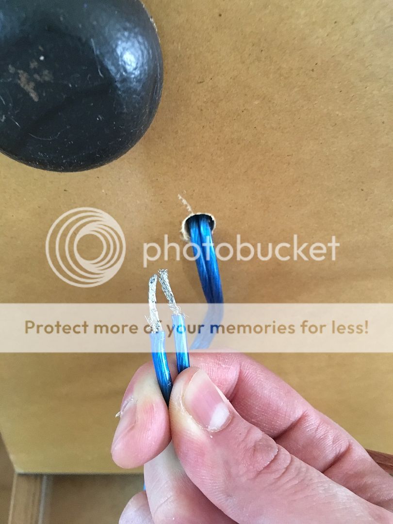

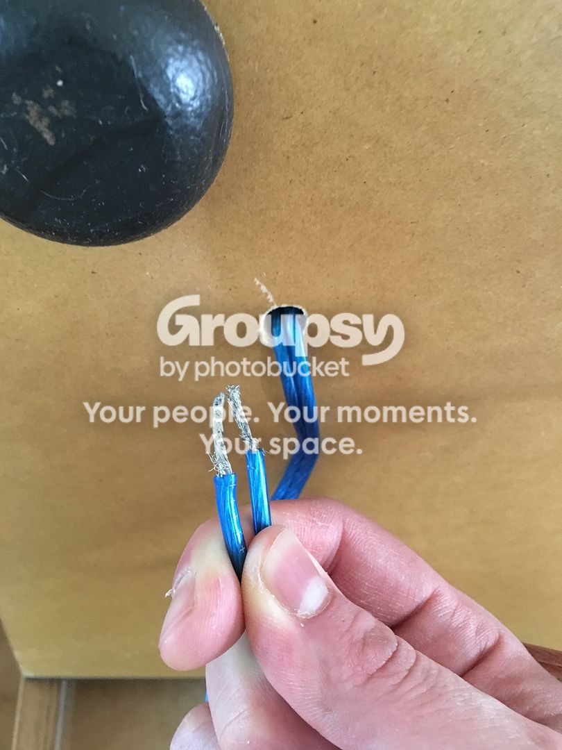

    Wires are Tinned to Prevent Corrosion:
    [​IMG]

    -This unique pair was veneered with Teak and Signed By the Artist himself!

    The stickies on the terminals and wires between the top and bottom modules are placed by Dennis Murphy - I would guess as a safe-guard against someone assembling the speakers and reversing the wires for the tweeter and the midrange.
    "The owner" did add the foot pads for use on hardwood flooring.:)
