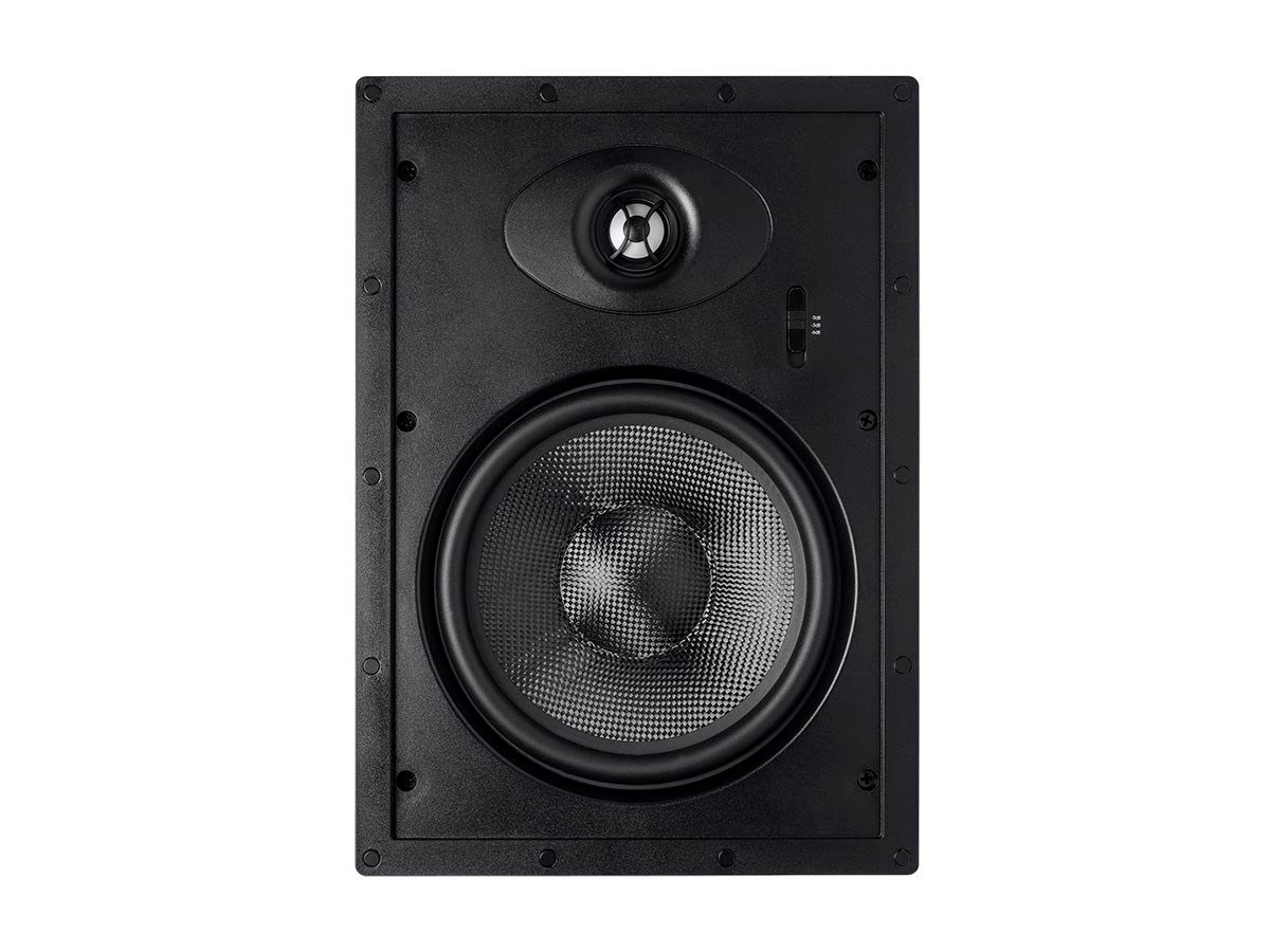

You don't need to shell out $400 X 10 for in wall speakers. These speakers have a good reputation.
They are currently out of stock. Monoprice are a good outfit and I bet they will be back in stock. So you can have replacements, which I bet will be better then what you have for $45 X10. May be that will cheer you up?
This is the one I recommend for you.
