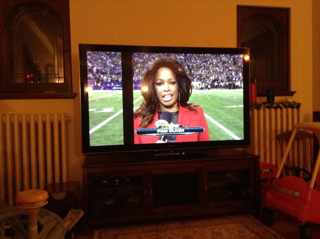

I'm not sure the buzzing I had was normal. I left the room tonight and when I can back there was a 3" vertical black bar about 1/4 of the way across the screen from the left. It is on all inputs. Turned the set off multiple times. No luck...and now the warranty is 3 days expired. Anyone have experience dealing with panny in these situations?

Another update. Panny sent a local repair shop to replace the board controlling that 1/3 of the screen. It did not solve the problem so they took my TV away for major surgery. Apparently the next step is replacement of the entire panel. Since it has to be shipped by freight, the repair guy said the total cost was likely more than the TV retailed for. Makes you wonder about the economics of it all, but it looks like Panasonic is stepping up!

Should know more by the end of the week. The repair guy did say that he had seen this issue before but only in 65" panels. He said it has not been an issue on other panel sizes.

Well my repaired TV was finally delivered yesterday. They ended up replacing the entire panel but it was not available for many weeks.
