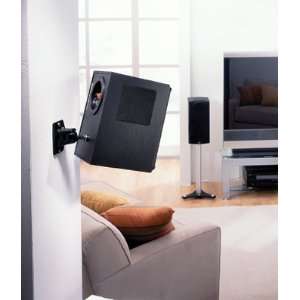

If you plan to just directly wall mount and not use brackets to angle them down a bit, then close to the ceiling isn't a good idea
They will be angled down like this.
j_garcia
j_garcia
They should be fine like that then :) That they are sealed is a bonus in that situation too. The CMT340SEC might be overkill for those too - I'd consider just getting another HTM200. It isn't that they aren't timbre matched, but I think I'd be more inclined to go 170s or all 340s up front ideally because of identical midrange drivers and I don't know if that's an option. The HTMs use smaller mids than the others even though they have the same tweeter. Identical speakers with the same crossover point up front will blend about as seamlessly as you can get.
