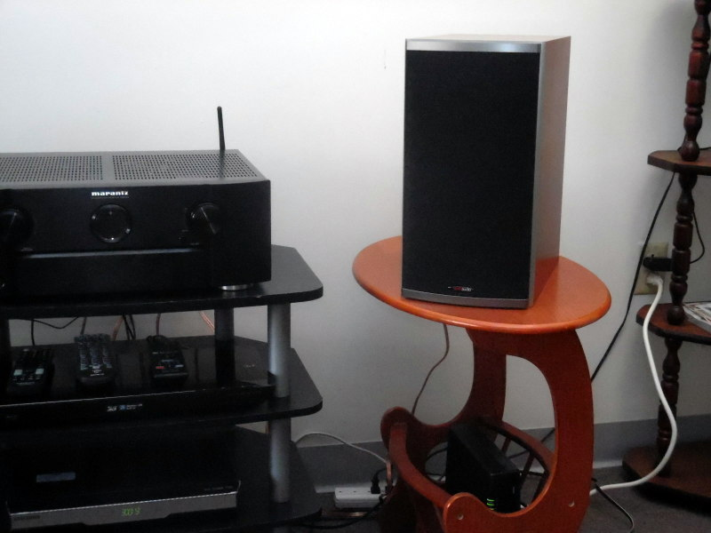

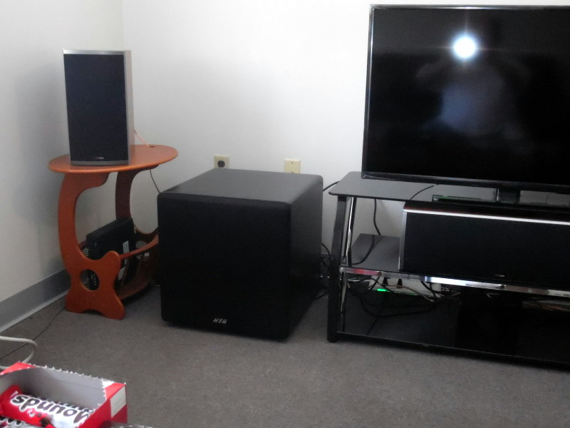

My goal was to get as a musical sub as I could get given my budget. The ULS-15 MK2 fulfills my need perfectly. Yes, it is a little BIG for MY room. But, I have it upfront in between my left front speaker and my tv stand. The other will go on the other side close to a corner, just like the one I have is located now. Also, have another option and that is to place the second sub more near field next to my seating position also on the left side.

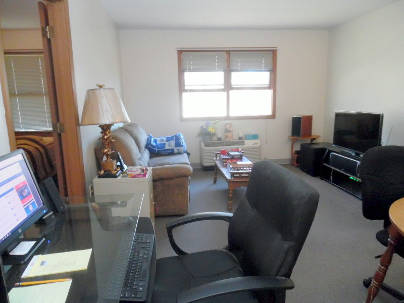

The room is open to my bedroom/bathroom and my kitchen/doorway. I reside in a 1BR apartment. Have posted a few pics here:
And here:
This is the other side I am referring to when placing a second ULS-15 MK2 sub. That is, I will move that stand in the corner and place the second sub in between my ty stand and the front right speaker. Have NOT gotten my RTi8 towers set up just yet. The RTi6's YOU see here are going up on my side walls.

Ideally, you could locate the dual subs equidistant from your LP (judging by your photos, it looks like you may be good on this!). Then the phase/time alignment should be very close.
