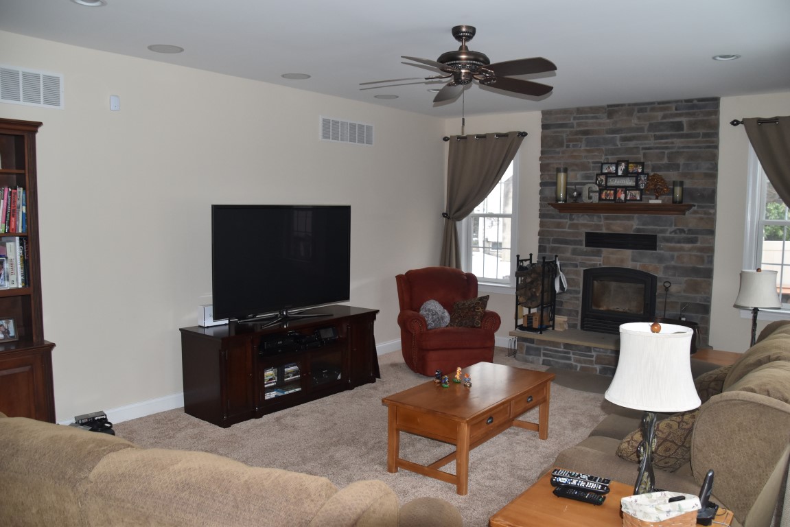

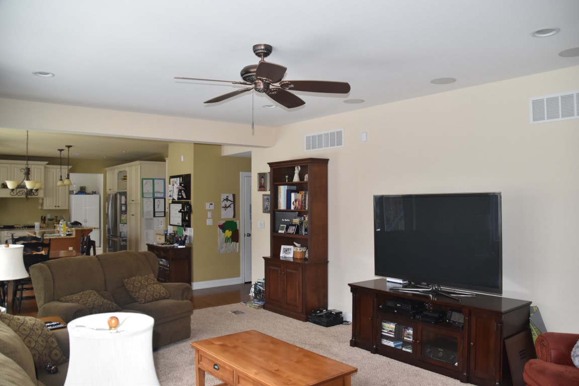

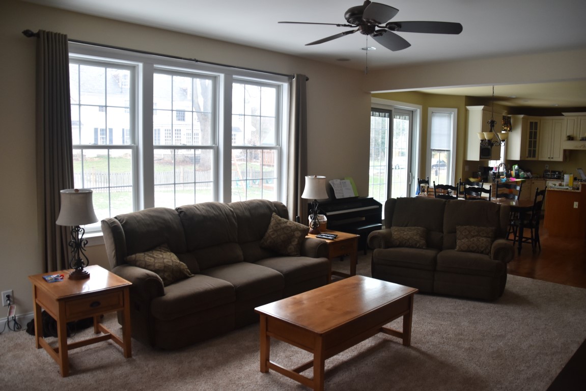

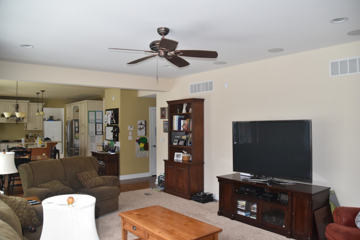

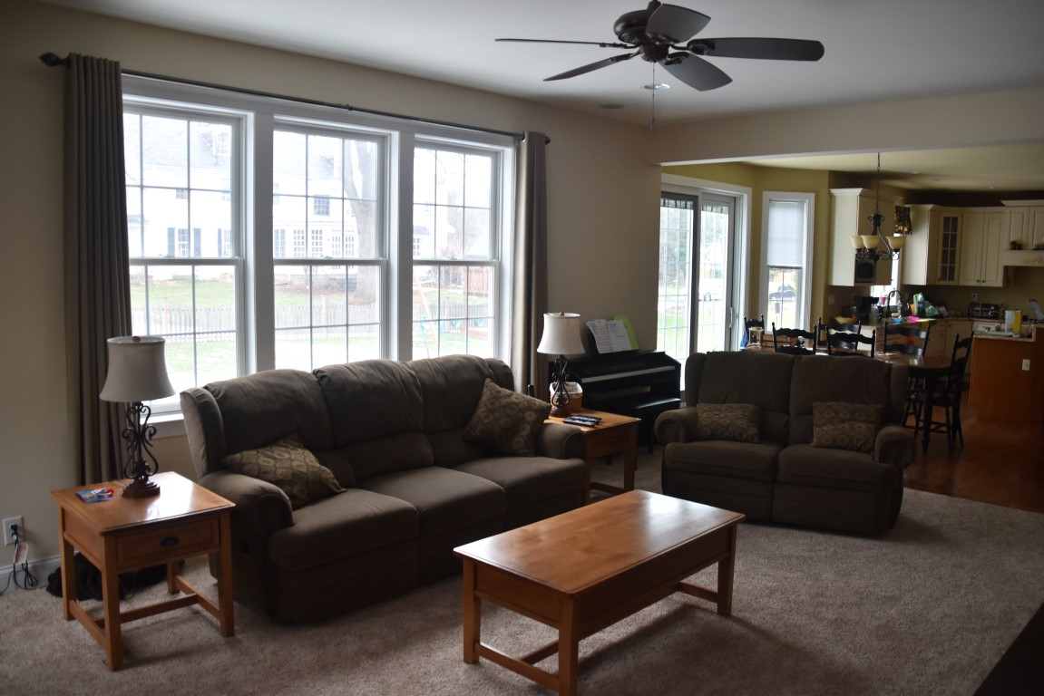

4 pics of the family room are attached. Hopefully they post OK.
The room is 20 wide by 15 deep, and opens up into a breakfast room/kitchen area, where I often am when I listen to the music. Hopefully that helps.
And as far as a sub, I just replaced that a few months ago..Definitive Technology SuperCube 2000 subwoofer.
4 pics of the family room are attached. Hopefully they post OK. View attachment 20363 View attachment 20364 View attachment 20365 View attachment 20366 The room is 20 wide by 15 deep, and opens up into a breakfast room/kitchen area, where I often am when I listen to the music. Hopefully that helps.

Nice looking room. Definitely a large room especially your "sub" (it's really too small but for maybe a very small bedroom/office; 7.5" driver can only do so much and Def Tec specs are usually less than honest with their bass modules, that they're small is really their selling point but bass thrives with larger drivers and cabinets, particularly sub bass territory). Subwoofers need to deal with the entire volume of space open to them, so that includes your breakfast/kitchen area; I'd use several larger subs in a space that size but that's me :)
Having your speakers point down, particularly the mains up near the tv, is just not going to give you the best dispersion patterns for good audio, particularly if you're sitting over in the kitchen/bfast area. Aesthetics/WAF may rule the roost, though it limits many audio setups in the home. Any tolerance for standard speakers or at least in-walls to flank the tv?

IMO if you are looking for movie theater sound, as HD mentioned, you'll need to get your speakers down into the room and the fronts should be along the horizontal axis of the display. I believe surrounds should not be in the ceiling either but again, we don't know your waf factor. Or your own approval factor even. I would also look to return the def tech for something better. The sound difference in receivers as said, will be in the room correction more than anything else. So depending on what it's driving you might not notice much. The real question is how much value you place on connectivity. For me, it matters but you may not find the need. Might want return the avr for a denon or Yamaha that you can read the display.
