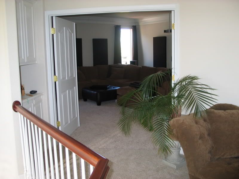

Just putting the finishing touches on this room. This dedicated space was the former top half of my 20' tall family room. The new space is approx 3600 cf and is sealed. I have installed room treatments and it is sounding pretty good.
I'm running Revel speakers, JL subs, Emotiva DMC-1 (Integra 9.8 on order), Sunfire amp, Tosh Xa1, Moto HD DVR, Pioneer Elite DVD player and a Velo SMS-1 . Much tweaking yet to do.
Here are some pics:
Outside looking in

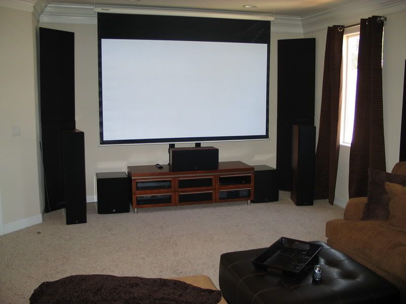

Front with Plasma
Front with PJ screen down

I agree with croseiv, your room looks very elegant, warm and impressive. I see you are using the GIK Tri-Traps and panels...they look nice in there. Congrats!
One question though, whenever you stated that this was formerly the upper portion of the family room what did you do, enclose an existing loft?

No loft, I simply built a floor/ceiling in the existing room 10' up and created two rooms out of one. The entry to the new room was a 2nd story landing overlooking the old room. The new room has 9' ceilings just like the rest of the 2nd story.

VERY clean, attractive, and speaker positioning is awesome. The use of acoustic panels is also a bonus. The furniture also looks really comfortable. The low profile AV credenza is also well thought out. Very nice home with nice equipment. I love Revel speakers and I am considering an Emotiva amp myself.
I may have considered opposing subwoofer placement in a room of your size but that would be my only small quible. What sounds best is whats important.

That is a sweet setup. BTW, I am planning to eventually to the same with a TV behind a motorized screen.

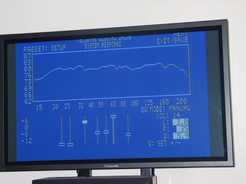

Thanks, I like your room too ;). I have tried just about every possible sub position but the front position produced as good if not better bass when aided by the bass traps and the SMS-1 EQ. The SMS graph from the listening position looks like this:
Lots of cuts down low and a big boost @ 60Hz but it sounds good.

I have read several articles that suggest that it is not a good idea to try to "cut down" peaks using equalization, one should only add boost to dips in frequency response. I forgot what happens when you do this but I guess that will be tonights homework. This information may greatly affect how you approach achieving a flatter frequency response. I know if did for me.

Actually its the other way around. You want to cut as many peaks as possible while trying to boost as little as possible. The reason you want to do this is because, generally, larger, more problematic, dips in frequency response are caused by cancellation due to room modes while peaks are caused by room mode excitement causing addition of to waves to create a larger SPL.
When you cut a frequency response all you are doing is sending less power to the speaker at a given frequency so that it isn't too loud and thus giving yourself a flatter response. When you boost frequencies you are forcing more power on the driver, thus making it work harder, but at the same time the room modes stay excited in the same way so there will still be a dip because the waves will continue to cancel. If you bump up the power too much you might end up overdriving the woofer, especially at lower frequencies.
While sending too little power to a woofer is bad, in general, if you eq properly you won't be sending to little, just less. On the other hand if you over compensate trying to raise a dip you can end up blowing a woofer or damaging it by working it to hard.
And adding boosting on an EQ very quickly decreases headroom, causing the amp to clip at rather low volume.

Westcott, avaserfi and no.5 have it right ... better to cut than boost. My Fathom subs have 2500 watt amps so I'm not too concerned about them clipping. I have played with the SMS-1 phase and Q quite a bit and the settings you see above yields the best response for most of the seating positions on the sectional couch with the sweet spot being where I sit;). If I moved the subs to the side walls I could get rid of the 60Hz null but introduce other issues. Now I know why folks pay the big bucks to have sound engineers design a room. OTOH, my room/system is sounding the best it ever has and I will continue to tweak it over time. The next step for me is some measuring software that is a bit more accurate and has a broader frequency range than the SMS-1. In the meantime, I'm getting a lot of enjoyment out of the system and appreciate all of the comments.

RMK, I do not think the average person could afford a calibration system with the sample rate necessary to properly EQ a room if that is what you are thinking about trying. EQ is VERY hard to do properly and that is why it is generally not recommended unless done professionally.
There are some good white papers on the subject on the Harman International site if you wish to investigate further before spending more money on equipment.

Westcott, actually I was referring to inexpensive measuring tools (REW) rather than additional EQ devices. My intent is to optimize the room with speaker positioning and acoustic treatments before going further down the EQ path. That said, the Velo SMS-1 has been very helpful in actually seeing the LF room response in real time.
Oh and thanks for the reminder re the Harman site. I've read a bit of Floyd Toole before and although a bit dry and scientific for my taste, there is much good info there. I'm more of a Room EQ for Dummies kind of guy:eek:.
