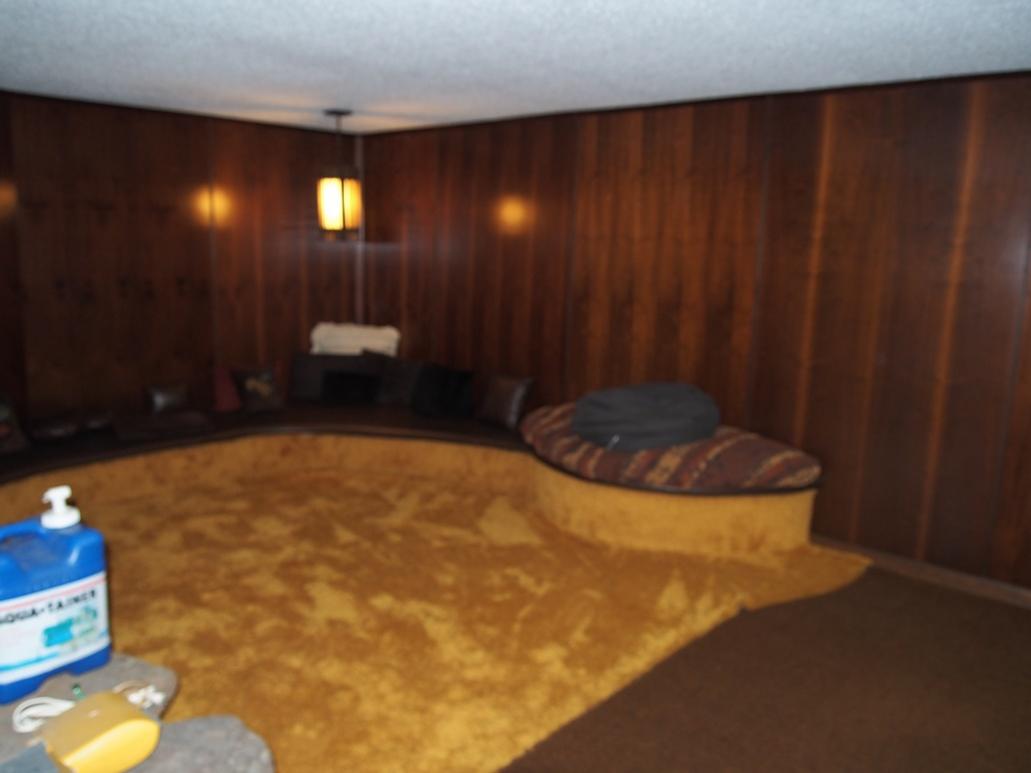

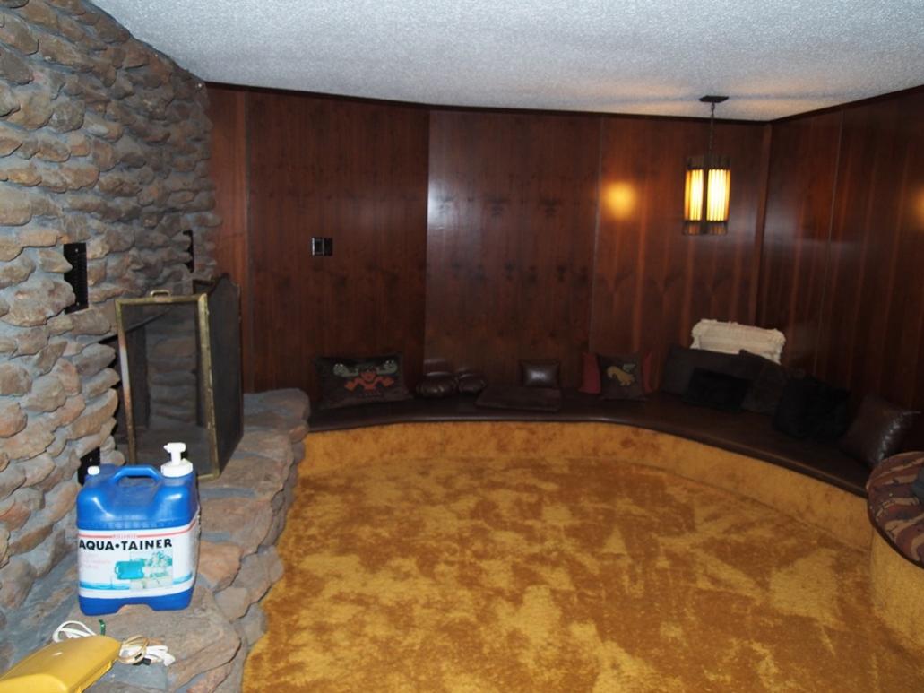

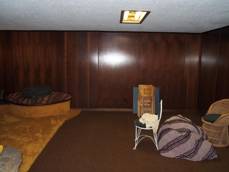

I will be purchasing all new home theater equipment this winter, and am needing some advice. I will post pics of the space when I get home from work. The room is roughly 25 X 12, and has complete light control available. The ceiling is about 7.5 to 8ft high. My complete budget which needs to buy a projector, screen, receiver, bluray player, and surround sound setup is $10,000.

The built-ins along the wall are coming out, and the carpet/paneling are being ripped out as well. Thoughts on flooring/wall treatments?

For the best experience you will likely want to look into room treatments. Might want to work that into your budget.
If you are at all handy you can put together sound panels rather easily. (DIY)

Last but not the least, the wood paneling looks great but it will make the room very reverberant in the treble (aka. speakers will sound treble heavy). Plan on having room treatments to tame this aspect. These can be DIY'd cheaply. Companies like Auralex, GIK Acoustics and Real Traps have you to send in room characteristics and get custom recommendations.
