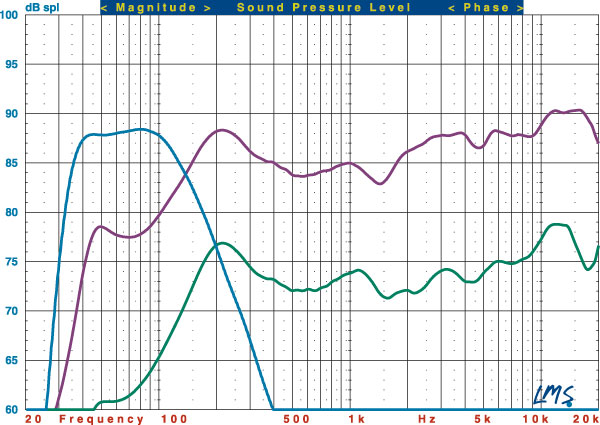

HT Labs measuremebts

That is a horrible response. You can see declining response at 1.5 KHz and the a horrible high Q resonance (honk) built in at 150 Hz. There is only one way those speakers will sound and that's awful.
Audysessy got it right. It detected where the speakers were rolling off and tamed the honk.

What does this mean?
What it means is you took some poor advice from one person at the other forum,
and you ran 120 hz test tones on your front speakers - and you turned the volume
up, and blew two speakers. Note for the future > do not toy with small speakers.
It also means that 100 hz is too low to cross the speakers over with a sub. Just
as was stated in this thread, and at the other forum. The two speakers have no
real low bass. They do better from 150 hz up. > Look at the two lines green and
purple, where the line falls between 100 and 200.
Now try to find some bigger speakers.:)
