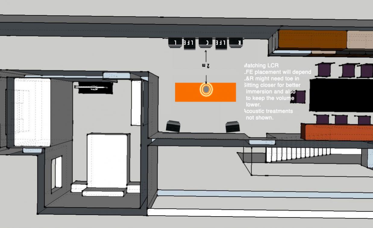

Acoustics, I'd probably be doing something like this (again, I'm a bit blind without seeing the room):
http://gikacoustics.com/acoustic-advice/
(this is a stereo system, but notice where they put the chair? :) )
I had in mind you treating the sidewall, then if the ceiling is opening thought black bass traps could hide nice. Then in the front corner, a bass trap stack. Rear wall diffusion at the direct points of the left and right, with absorption in the center.
When you clap your hands in the room now, what does it sound like? Does it echo? Like a fluttering sound decaying of the clap?
MidnightSensi2
Messy sketch.... again, depends on the room. Also I'd have the ceiling treated. Floor just put a REAL rug (the varying fibre lengths soak up a wider range of frequencies than the synthetic stuff).

Something about this sketch has me busting up laughing...
More seriously, are you sure that's not over treated? I'm trying to say it is, more just trying to learn about opinions of room treatment.
MidnightSensi2
He asked for a general idea.
This is based on a (unknown, which he is aware of) concrete room with an open ceiling. That's very live. A typical American living room has so much **** in it....and is not all, but a lot of, drywall. That's not typical worldwide. Carpets, couches, bullshit on every surface, blankets, dogs, drapes, whatever lol and you get absorption 'to taste' and generally have more trouble with the low end... go move into a bare concrete space and it's very different. Without treating first and second reflections, yikes. Like being in a glass and tile sealed shower. Bass, literally sticks. My room is concrete. So, I put carpet, bass traps were needed, and a lot of absorption.
Likely this is under treated, but being nearfield he has a great advantage.
Also remember, it's to give a general idea. Not a plan.
And he might say 'hell no!' ... and most people do. (That's why their rooms generally limit their experience, not their speakers).

Also, the photos confirm my feeling of going nearfield. I'd tuck the whole system in that corner. Can run the left and right surrounds to your ears side, with one to the side on the wall and the other the cable runs under the couch to a stand and up.
This would cover 3 people nicely, and keep a lot of free area behind for walking (more so than before). The center would be the sweet spot. You'd be surprised at the output of the Genelec, and the built in protection is nice.
