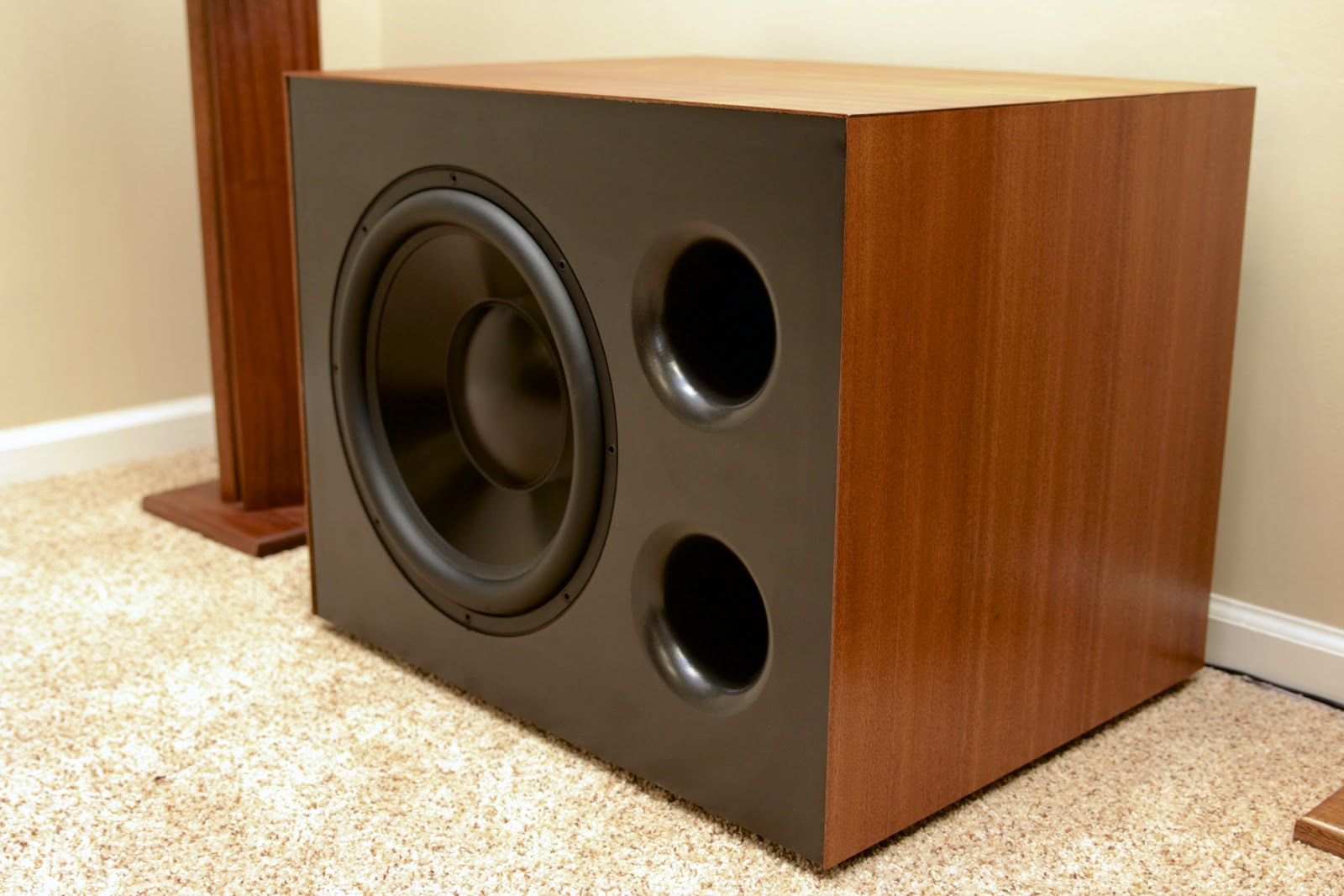

Can I use double vents of 267.5mm instead of one with an elbow? It would create a nice symmetry.
Also, can I placed the sub on its side if I move it to another room and decide it doesn't fit the way it's built?
What I mean by that is that the longest part of the enclosure will be on the floor (the 610mm side).
Of course I'll add rubber feet for that.
It would look like this, basically:
In fact, I think I wanna copy this design in terms of the double vents and the veneer and black painting. I think it looks beautiful.
Yeah, you need to make sure they plan to build in the vent pipe before sealing it up. It'll be much more difficult to install the pipe into a completed 6-sided cube. If they refuse, then I could redesign the box with a folded slot vent.
You can do two vents, but you should use two 5mm pipes I think. (Edit: wishful thinking) What sizes of pvc pipe do you have available? I'll have to recalculate the vent length. I don't think there's enough space in the box for two 10cm double length tubes, and their add displacement might mean we'd have to make the box larger. You can flare 5mm pipe using a heat gun and a metal mixing bowl for the look you want, and flaring will also reduce turbulence / chuffing.
Yes, this sub can be laid on its side if you prefer and can spare the floor space.
You can do two vents, but you should use two 5mm pipes I think. What sizes of pvc pipe do you have available? I'll have to recalculate the vent length. I don't think there's enough space in the box for two 10mm double length tubes, and their add displacement might mean we'd have to make the box larger. You can flare 5mm pipe using a heat gun and a metal mixing bowl for the look you want, and flaring will also reduce turbulence / chuffing.

Firstly, I've got to say that I was mistaken about two 5cm vents being a suitable substitute for one 10cm vent. It would actually take four 5cm vents.
The tricky balance with vents is that the thinner the inner area of the tailpipe, the faster the air moves. If it moves too fast, you get audible port noise. I've read that around 20 meters per second at 125 watts is a good target. You'll want to stay around mach 0.05 or less in any case. But a wider tailpipe requires a longer vent to achieve the appropriate tuning frequency. And if the pipe is too long, it won't fit in the box. The single 10cm pipe achieves proper tuning near the target air velocity at a length that's reasonable for the box size. Using two 10cm pipes would require you to double the length to keep the same tuning frequency.
Before I investigate whether a two-port design is possible, I'd like you to tell me what size PVC pipes you have readily available.

Slotted design. The slot vent is 2.5cm x 34.4cm x 58cm, which should result in a tuning of 23.5Hz if the net volume after displacement of the driver, amp, bracing, and the vent itself is 71L. This model uses a wood thickness of 18mm this time. SketchUp project file is attached to the bottom of this post.
I noticed how the example photo you posted had a seamless front baffle, so I designed this one with the large pieces as the front and rear baffles for the same seamless finish.
Be advised that with a single front baffle the driver will be surface mounted. If you want the clean look of a flush mount driver as shown in your photo, you'll have to do a double front baffle. The inner one will have a hole cut for the basket (282mm), while the outer one will have a hole cut for the driver's outer diameter (315mm). This would make it easier for your carpenter to round over the slot on the face of your box if you want to pursue that. But all this will add weight and expense.
With this design, the vent air velocity at 125W peaks at 19m/s at 20Hz.
