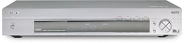

Customer with the help of our tech. advisor, has selected the following equipment for his 26X32 Ft. multimedia Room.
* Sanyo PLC-XF31N/NL multimedia LCD projector
* Pioneer VSX-59TXi A/V receiver
* Marantz PMD-970 professional DVD changer
* Sony SAT-HD300 directv HD set top receiver

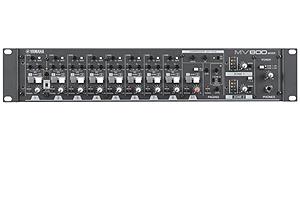

* Yamaha MV-800 (8 channel mixer)

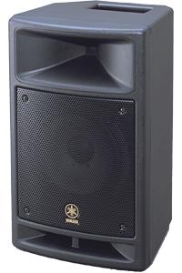

The Yamaha powered speakers(8) will be installed on the walls for a complete surround sound cinema style.
Each Powered Speaker will get a monoural signal from the Yamaha MV-800 (8) Channel Mixer.
The Yamaha MV-800 (8) channels mixer gets an auxiliar output signal from the receiver and will output a non stereo signal to the (8) speaker monitors.

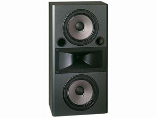

If you want a perfectly balanced surround package, then the JBL Synthesis is top, top, TOP notch. It is what I have installed into the most discerning of our clients home theaters when money allowed. Nothing I have heard in a theater really has ever beaten it, though I haven't had the pleasure of doing a full blown Meridian theater either.

Mtrycraft, the set up with have in mind is with 8 Yamaha MSR-100 powered speakers for both sides of the room and back. In the front alongside the screen we need 2 center speakers and 2 subs for down below the screen. The MSR-100 will be installed on the walls.
OK. Can you use the same speakers that is the front left right speakers as center speakers then?
Mr.T
Yes we can, and most likely we will also choose 2 Bagend Infra-18" subwoofers. Thank you for your help mtrycrafts!

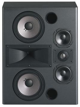

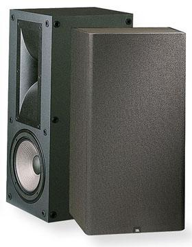

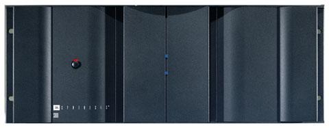

We finally convinced the owner of the house to go with a total different system than what he originally had in mind and spend a lot more money or we would have no choice than cancelling the installation.
The system is the JBL Synthesis One:

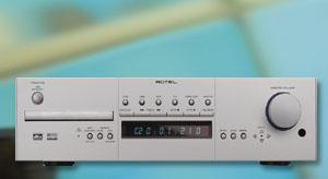

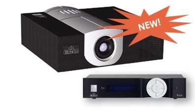

and these: which includes a Runco VX-1000d (very expensive) but he went for it, and a Rotel RSDX-02 DVD Player.
By the way the Runco has a resolution of 1280X720, a contrast ration of 2700:1 and 1.500 ANSI Lumens good stuff!!
Some of the equipment he had already bought from B&H Photo N.Y.C. will be returned tomorrow for a full refund. Thank you for your help as always,

That's awesome... ish.
If you have NOT worked with Runco before, be very, very, VERY-ware!!!!
Runco has almost zero customer support in my dealings with them. They're product is almost always OEMed by another manufacturer and then they go in and hack things up. Every SINGLE product I have dealt with from them has failed and been extremely slow. It is what I call a Ferrari product. It's really nice, but needs to be in the shop six days out of seven, so you better make sure your client is aware of that before the purchase.
NOT that Runco stuff doesn't look great, it does. But, it just is not like a reliably high end Japanese car (NSX?)... The Runco stuff is just really sketchy. Plus, they're customer service is not, in my opinion, very responsive. They talk a good talk, yet don't play a good, or particularly fair, game in my experience. In fact, they were so bad that the highest end Crestron installations ($100,000+ A/V homes) were not allowed to include Runco product.
What is left?
How about the top of the line Maranta, Sharp, or if you want something that I consider premium - the Sim2 300HT which is much more stylish and has a phenomenal picture. It also allows PC's to be passed through pixel for pixel. So if the PC outputs 1280x720 native (which is should) it will not be touched by the projector and will look flawless on screen.
The Sony Qualia is also supposed to be phenomenal, though I have not personally worked with that.
I warn you on Runco. It sounds so good on paper, but it can bring you to tears when your client has problems with his system and Runco won't do anything to help you out after he spends a small fortune on the projector.
Hope that makes sense... any others who have installed and use Runco regularly want to chime in with thoughts?

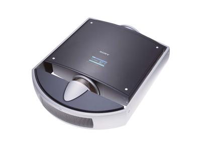

Customer made his final desicion on the Sony Qualia SXRD Projector instead of the Runco for a woopping price of $ 22K (do you think he paid too much?) and he also picked up a Middle Atlantic Equip Rack. Now I only hope that he has enough money left over to pay for the installation, I'm just kidding!!

The Ceiling bracket for the Sony Qualia projector should be coming in this week including the JBL Synthesis equip.. I figure in a couple of weeks the system should be up and running.
If interested here are some reviews on the Sony Qualia.
http://www.projectorcentral.com/sony-qualia-004-user-reviews.htm
