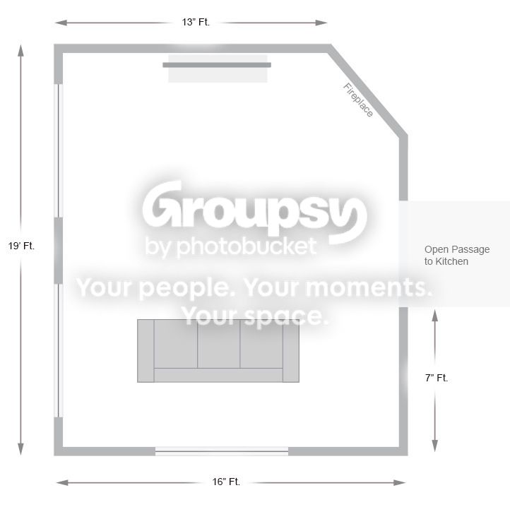

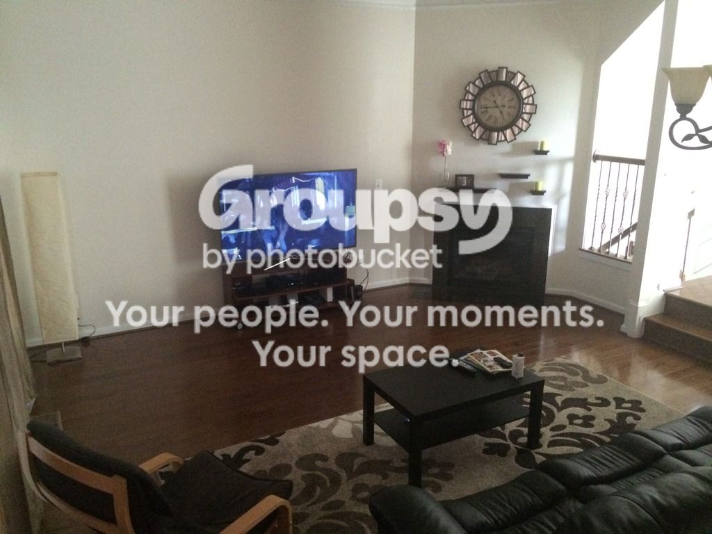

Room Size:
The HT setup will be in a town house - living room with dimensions as 19L x 16W x 10H. One side of the room is partially open to a stairs and passage going to kitchen. Viewing distance is approximately 14 feet/4 meters. There is a fireplace on the side of the TV which takes up nearly 3 feet. The room is not wired for Home Theater. :(
That's a 60" inch Samsung TV.. o_O it looking small..!
