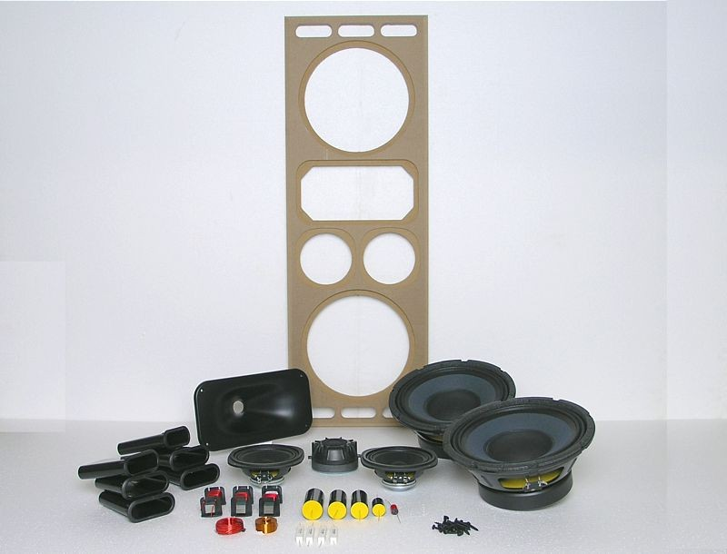

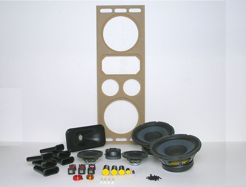

Go big or go home. Just in case DIY is an option. Probably not, by way of the dialog in this thread, but for that size room these just popped into my head.
"Elusive 1099", named for the 10" woofers and the 99db sensitivity.
A kit pair of these is around $800. The woofers are now black, instead of the blue in the photo. The average AVR should drive these to insanely loud levels.
I have heard the 1099s on a couple of occasions, they are terrific speakers. Yes, they can get insanely loud, in fact we drove them way beyond reference, and it was so loud I became worried about my hearing and left the room. But they did not lose their composure, even at extreme loudness levels.
MrBoat
I think all of their speakers are pretty intense. Same with the Fusion-12s. You'll quit way before they do and distortion is not even on the radar with as loud as I have been able to stand them, briefly. My AVR is rated to 120w and the speakers are rated to 500w as are the 1099's. Being that both are close in sensitivity, I can't imagine using a portion of that other than an auditorium or stadium.
