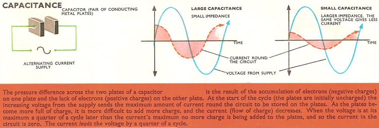

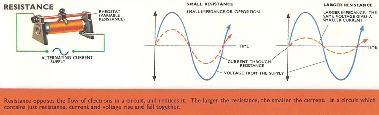

I knew I would get the order wrong. In a capacitive circuit, current leads voltage and an in inductive circuits, current lags voltage. Its been 30+ years since I played with this. :eek: As current begins to flow across the capacitor, a charge is being created, hence the voltage build up across the capacitor ....still 90 degrees difference in a pure capacitive circuit. With a pure inductive circuit, the voltage applied across the inductor causes a field to build across the coil which in turns induces current flow. My apologies for having that mixed up earlier.
Here's a pic that illustrates pure resistance, inductance, and capacitance circuits.
