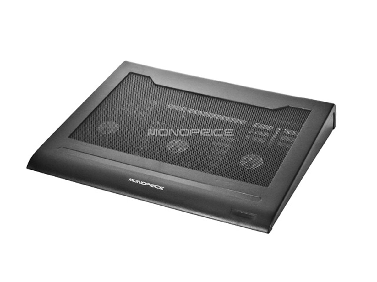

Just ordered a couple of these for less than $13 plus shipping. There made for laptops, but I am going to do a little re-engineering and see what results I can get.
