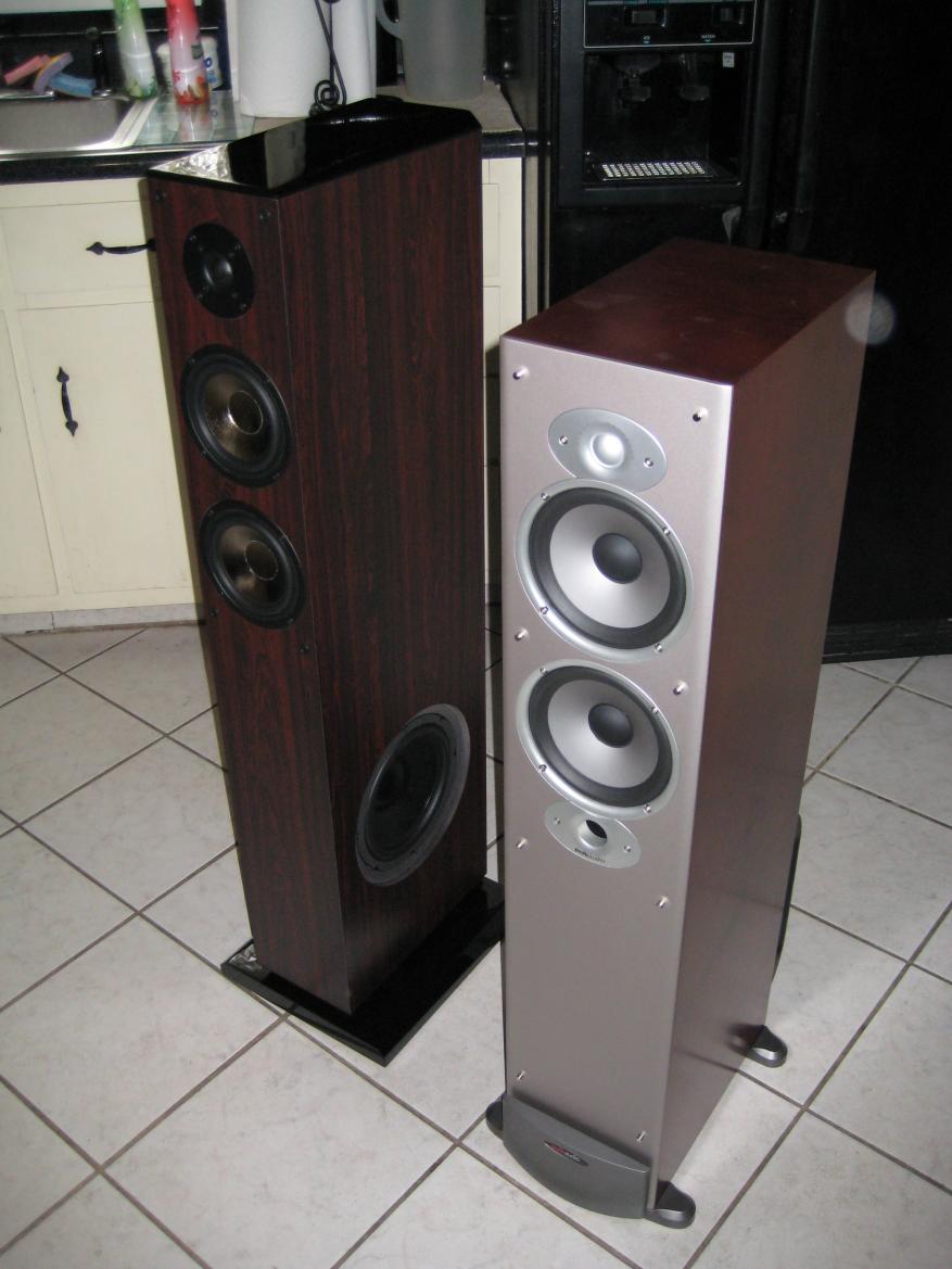

Is that a Piano black finish on your system? It looks pretty nice!

Yeah that is the stock gloss black EMP finish; Classy look to them!
I would prefer to go grill-less but my dog's tail would whip right through one of those woofers.

I was also going to include a side by side of the Klipsch RF82 in black next to the Polk RTI and EMP EF30T but my traffic was blocked (i'm at work)!
I'll see if I can get a pic up later.
