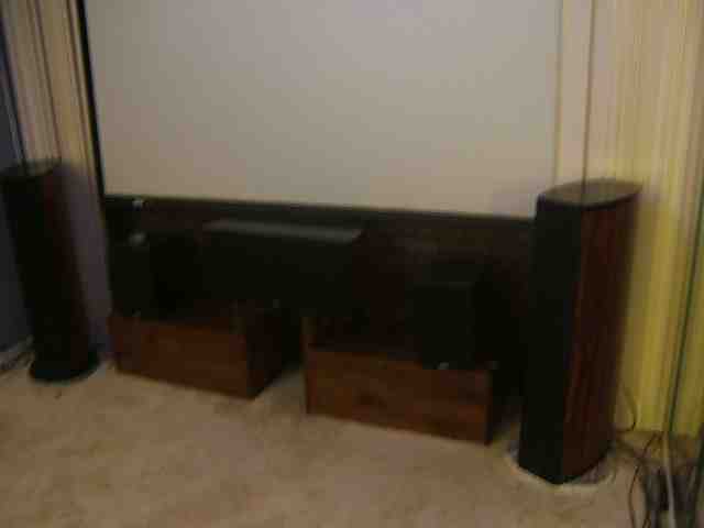

I have Rocket towers plus Rocket Center Channel and DynAudio between
the towers on each side of Center Channel speaker and Rocket Bipolar
on the left and right of the sofa. I could add two more in the back as I have
the space but unless I know that there are two more channels in HD I get
from HBO I won't do it as I do not have Blue Ray and have no intention
to get it. The reality is that most movies and tv is people talking to each other.
Which means the center does the vast majority of the work in non-action
films. I have the Emotiva processor and I have an extra Sony power amp
but I am not sure if it would be worth it.

You are already setup to use a Audyssey DSX, namely of the "wide" 7.1 variety.
The only real issue I see is that you are mismatched between the Dyns and Rockets for your front stage.
palmharbor
Mismatch?
I use a ES Sony stereo amp to run the Dynaudio and a 5 channel power amp
for the others. Again: Most of the audio still comes out of the center b/c dialog is there. I have some German MB Quart C 104's I just got to use in the far rear but they are part of my bedroom surround sound system. I will probably leave the living room H.T. alone for now
