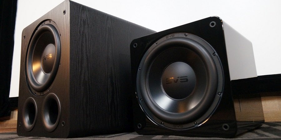

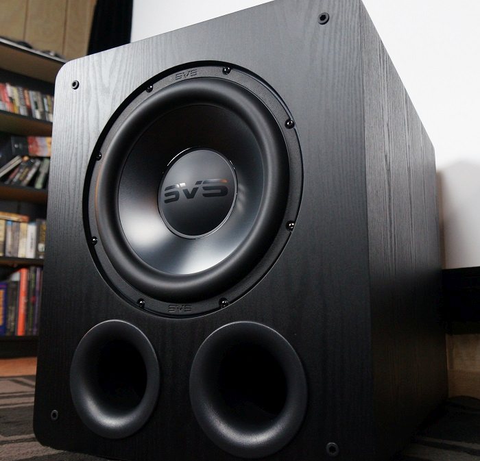

In for review today, we have the PB-2000 Pro. The PB-2000 Pro isn’t just the PB-2000 with a few new bells and whistles; it is a total redesign. It has very little in common with the previous PB-2000 and features a new driver, new amplifier, new enclosure, and also a new price in a $100 increase. The question we will be asking with today’s review is how improved is the PB-2000 Pro over the PB-2000: is it just slightly better? $100 better? Or is it a major improvement in all areas? Let’s dig in to find out…
