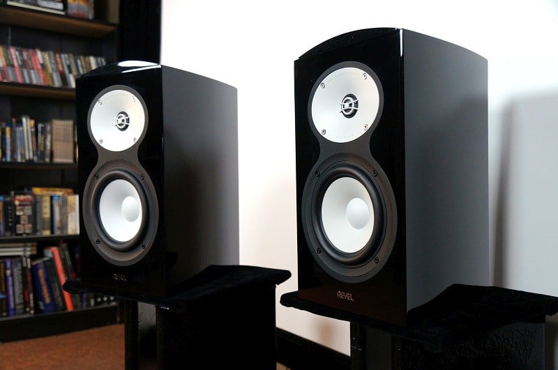

Revel had a good loudspeaker platform in the Performa3 line. In fact, the basic design was so good that Revel decided to see what happens when that design is pushed to the highest possible performance by using some of the highest-end components available such as air-core inductors, polyfilm capacitors, anodized aluminum woofers, and even a Beryllium tweeter. Today, we review their beefed up bookshelf speaker, the Performa Be M126Be. These are not inexpensive. At $4k a pair they are the latest bookshelf speaker, loaded with cutting-edge technology from one of the most admired engineering teams in the loudspeaker industry. The question is do they live up to these very high expectations? Read our full review to see how much these premium components add to an already solid design.
READ: Revel Performa M126Be Bookshelf Speaker Review
