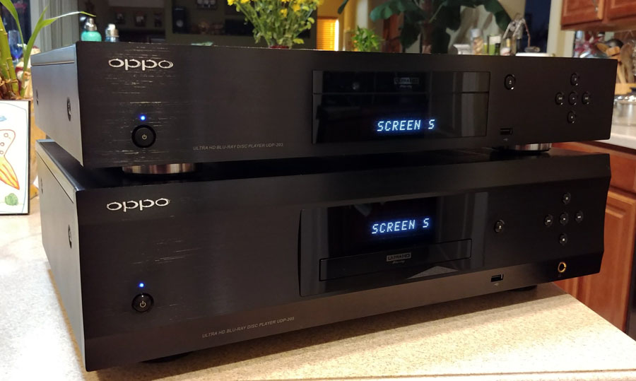

We reviewed Oppo's newest Ultra HD Blu-ray players, the UDP-203 and souped-up audiophile UDP-205. Both had very responsive interfaces, silent operation, and exhibited state of the art audio and video playback performance with every type of source material thrown at them. The UDP-203 and 205 leave videophiles wanting very little and both players should satisfy even the most critical audiophiles. So what does the UDP-205 offer for more than 2X the price of the UDP-203?
