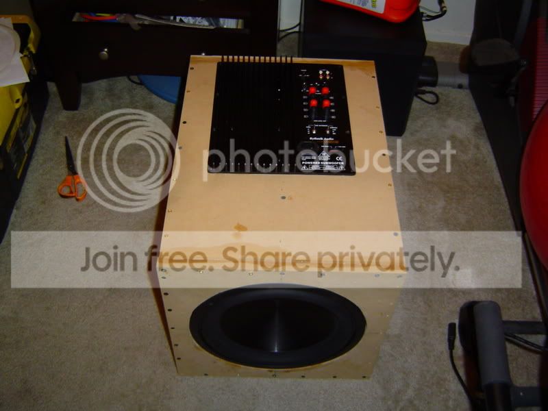

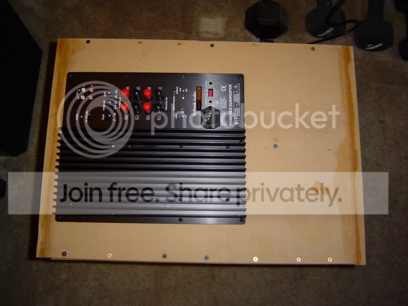

Hey folks,
I decided to give building my own sub a shot, so I bought the $400 Rythmik 12" standard sub kit. I spent about another $100 in materials, (wood, clamps, screws, glue, etc.) I finished it Wednesday and tested it yesterday, and it is an awesome sub!!! I would definitely recommend it to anyone that wants a great sub at a great price. If you have ANY building skills, you can do this. If I can do it, anyone can. I haven't veneer'd it yet, so it's not pretty, but it really does the job.
This sub is quieter than my Earthquake, but in a good way. The Earthquake was never able to shake my couch, but the Rythmik sure as hell did. I guess I was used to all the extra boom and noise that the Earthquake sub made, and I thought that's the way subs were supposed to sound. I used to wonder why my neighbors never complained when I watched movies. The bass seemed very loud to me. And it was loud. It just wasn't low. So there probably wasn't much of the bass frequencies to travel to the next door units. I think the Rythmik will get some people complaining. We'll see.
Now I know what people are referring to when they describe a sub as "transparent" and having "seamless integration". The Rythmik is like an old Chinese martial arts master, quiet and humble, but will knock you out in a moment's notice and you won't even see it coming. In a word, this sub is awesome. Now I want to go back and rewatch all my DVD's, as I'm hearing things I've never heard before.

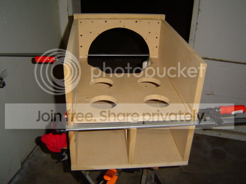

Nice work. Welcome to the world of DIY speaker building.

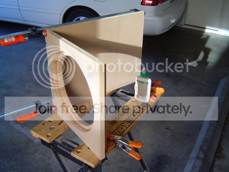

That Rhymik driver looks like a real hoss. It should easily outperform anything else for at least twice the price. Did you make the 2 ft³ sealed cabinet? Rhymik's design for the cabinet looks good. The internal bracing is very important in a subwoofer.
From your photos it looks like you have no problems with the level of woodwork needed for making speaker cabs. How did you cut out the circles for the driver?
Now you are ready for the next step - building some real speakers to go with that subwoofer :D.

Yep, it's the sealed version. I didn't want to deal with ports and stuff on my first box. I went with the 12" because Brian said the 12" and 15" have almost the exact same frequency response. The 15" just give you a bit more output. So I figured that extra $100 would about pay for the materials. Plus the bracing on the 15" box looked a little crazy.

Thanks for the kind words dude. Yeah, I think it came out pretty good for my first attempt. I had never even used my jigsaw before this project. For the circles, I just drew them with a compass and cut them by hand with the jigsaw. I was expecting to have to sand them a bit, but the sub fit like a glove the first time.
As for building some speakers, that's a maybe. John Garcia's got some homemade GR's that sound pretty damn good. Who knows, I just may give that a shot some day. But building this sub was VERY frustrating. Pieces didn't fit together perfectly, I had one of the sub bolt holes end up right next to a brace that was a complete pain, I had to apply about 3 layers of caulking to make it air tight, on and on and on. I just want to sit back and relax and enjoy the fruits of my labor for a while before I tackle another project.
But like I said, if I can do this ANYONE can.

That sounds a lot more like my own experience building boxes. Getting the pieces to fit well is hard. I wondered why you used so many screws :rolleyes:. But seriously, if you did that well with a handguided jigsaw and maybe a circle saw to cut the panels, you did real well. Maybe you have talent and don't yet know it. There are a lot of tricks to making straight cuts that you can learn as you work. Afterall, MDF is cheap. I also found that a plunge router and a Jasper circle cutting jig helped me quite a lot.
