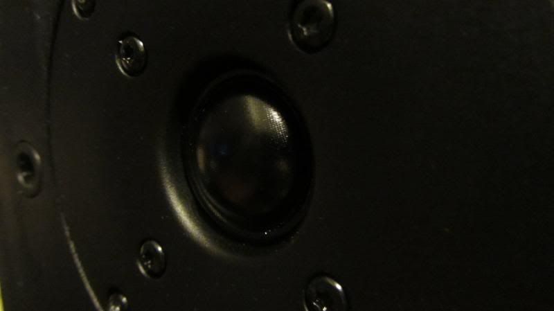

I have been playing with the prototype modded Pioneer BS22 speaker, modified by Dennis
Murphy. He has replaced the stock tweeter with a Vifa tweeter, and modified the crossover
to give what I call near flatbread measurements.:) > I have also compared it to the stock
version which I still liked and sounds good to me, based on the price. The one thing about
the BS22 speaker that stood out, was good bass from the small woofer, decent midrange
and decent highs for the price - with nice detail for music and movies. The tweeter was

The BS22-DNA, tends to remind me of the NHT signature sound > more along the lines of the
Classic Two speaker - the mod is better than the NHT SuperZero. One thing to note, this speaker
is less sensitive than the stock version.
The modified BS22 is neutral, clean/clear, balanced and natural sounding - it is neither forward
or laid back. It has good detail without needing the aid of a mushroom at 1khz, or a rising treble
in the higher octaves. The Vifa tweeter is smooth and detailed. Male and Female voices are more
realistic and clean sounding - instruments are more natural sounding - piano, harmonica, trumpet,
saxophone and guitar, all sound good with no edgy or sharp sound. Also, the violin sounds realistic
with no edginess. Drums and cymbals also sound more realistic and natural.
The bass even sounds better with less resonance - and I believe partly due to Dennis putting some
SonicBarrier damping, in the bottom half of the speaker. The main reason may have been to help
hold the crossover in place >> however I believe it helped, as the bass sounds more clean and less
boomy.
