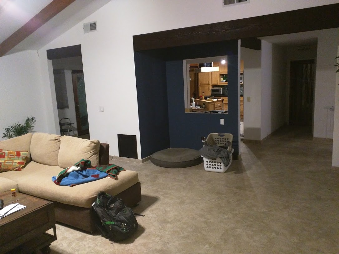

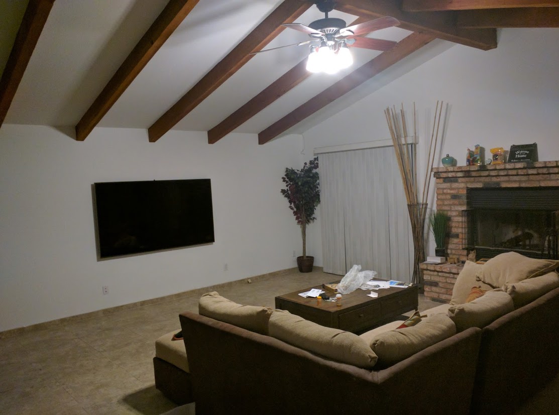

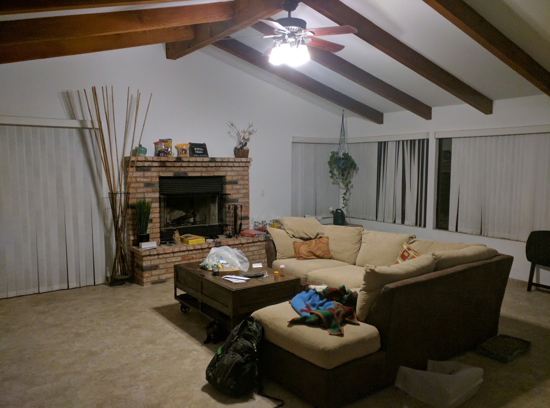

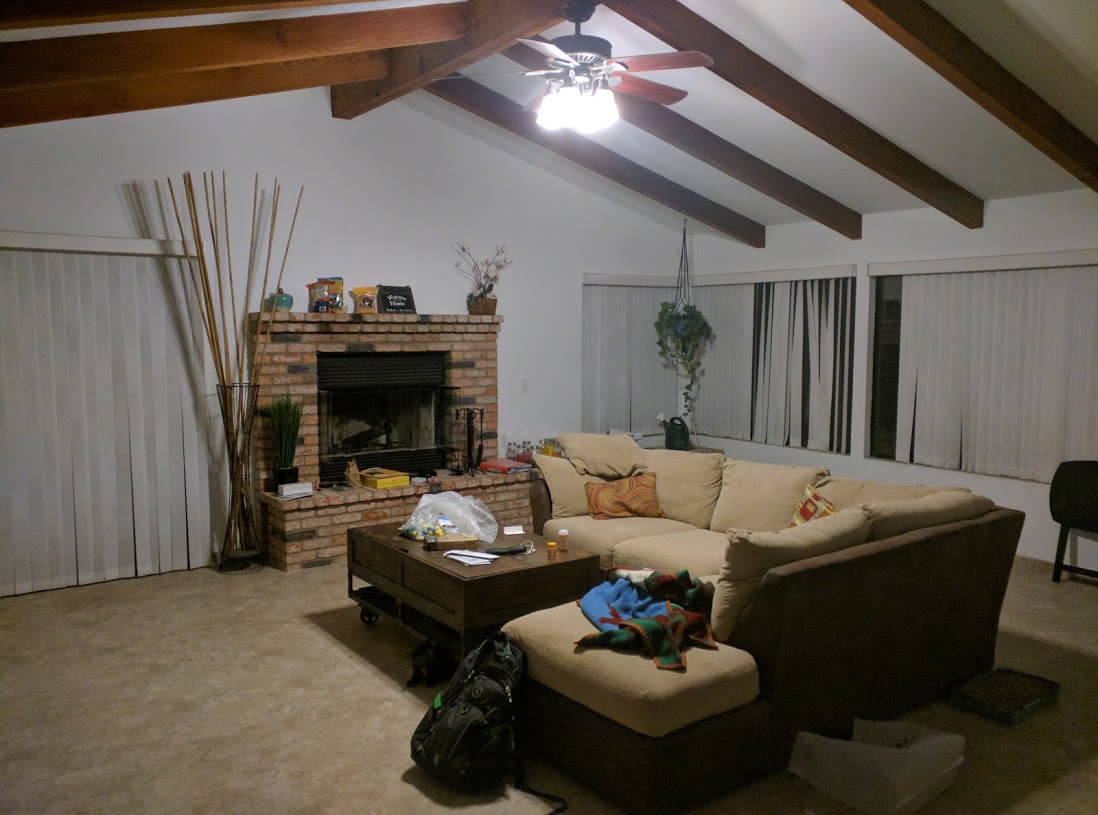

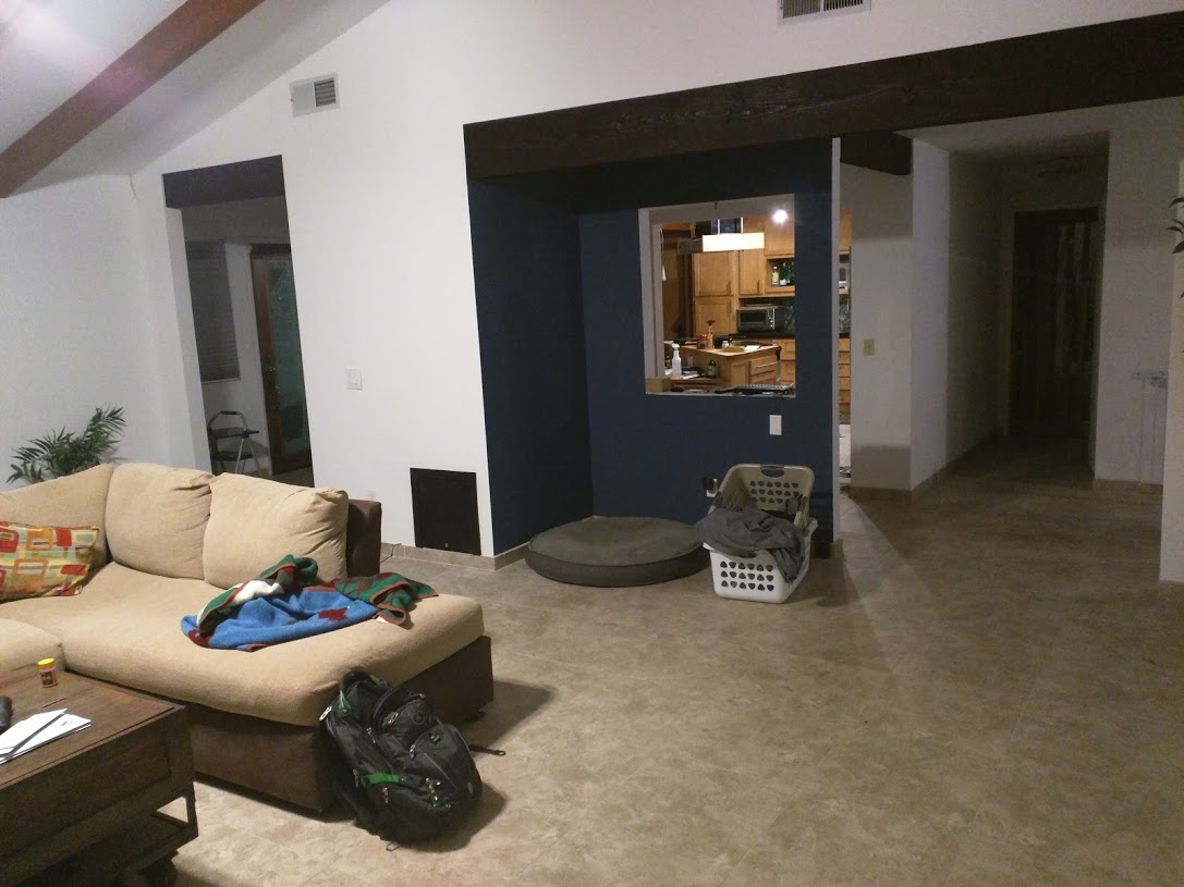

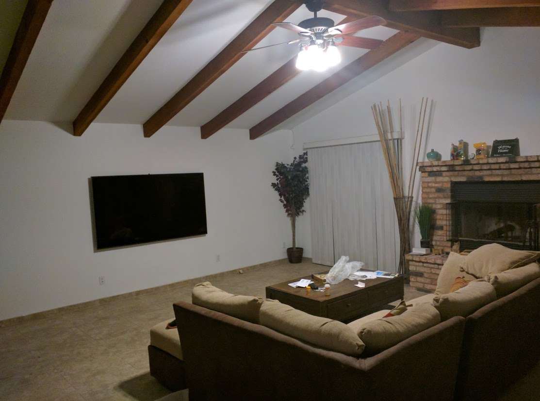

Thanks for your reply. Here are a few quick snaps of our living room. I'm refinishing our "new" house room by room, so please excuse the mess.

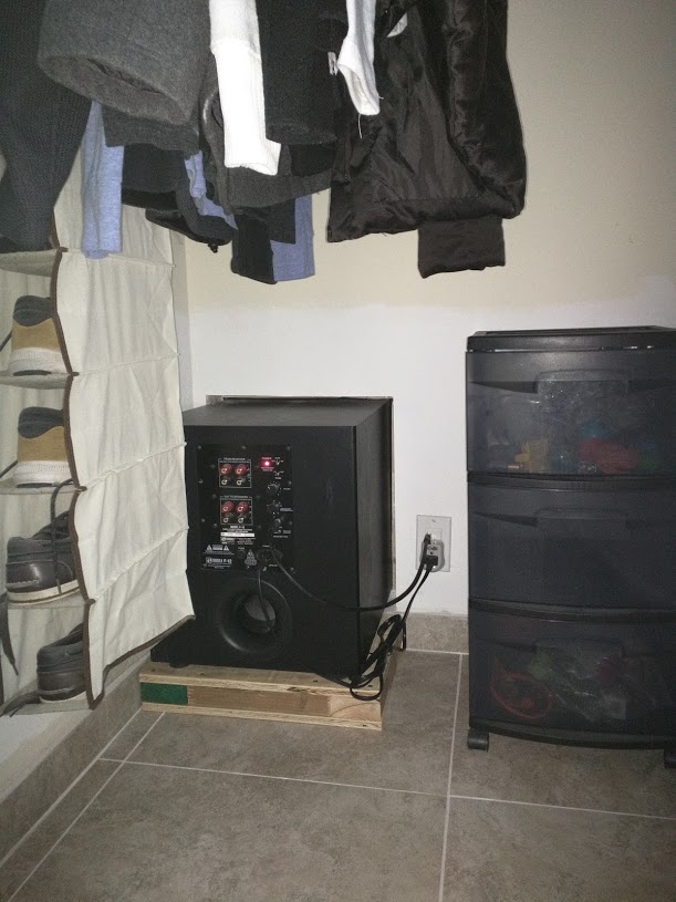

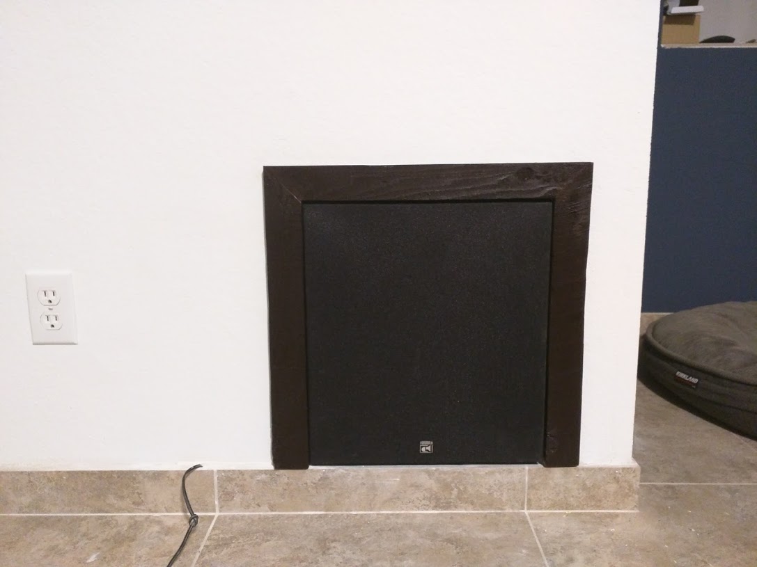

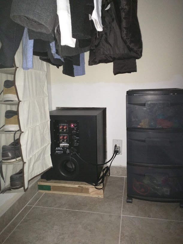

As for the Subwoofer, you can see it in the last 3 pictures sunken into the back of an adjacent closet. One of the advantages of this position is that it's very close to the couch where we sit. Without speakers hooked up to the receiver, I've put it on a delay to sync up with our TV speakers so I could test for rattle in real-world scenarios.
I did a lot of research several years ago, and the BIC America really seems to best bang for your buck. There were a lot of claims across independent sites that the BIC Accoustic and BIC America were the overall best sub $400 subwoofers. I used this one for a couple years in another setup and my only complaint has been that it's very big. I will probably use a BIC Accoustic when I finish my office/man cave. What are your criticisms of them?
In the first picture, you can see the floating TV. I'll probably end up building a pretty frame to go around it. Would it be better to position the speakers in-wall or in-ceiling? Unfortunately, there's a big ole beam running up the dead center of the ceiling that would make it difficult to center the center channel up there.

Hi @Jeffrey S. Albaugh
Tenshi: Thanks for the pictures. That really helps me to see the possibilities in your room. Looks like you are off to a great start. Now I can help you more. There are several ideas for you. 1. You can use In Ceiling speakers where you are able to do so. Looks like you should do an In Wall speaker above your TV. 2. You could use In Wall Speakers for your surround speakers. Are you planning to do 5.1, or 7.1 Surround? Which A/V Receiver are you using? Also, for a room this size it would be an advantage to have 2 subwoofers. Since subwoofer bass is non- directional, so there is a lot of leadway as to where you can place the 2nd Sub in your room. 3. You could also run speaker wires below the floor, if there is an unfinished basement below it. 4. Seeing that you have those dark beams on your ceiling, you could get black speaker wire and staple it to the side of your beams. It would be almost unnoticable. Which part of the country are you in? In terms of your BIC Sub, not to disparage you, but I believe these are made in China. Not exactly high end. IMHO, I think in today's world, there are many other choices there; including HSU, SVS, and many more. Anyway, I hope this helps. Good luck.

That should be a good sounding room, with the sloped ceiling above the TV. In that room mini speakers will a waste of time. Ceiling speakers are just about acceptable for surrounds, if you really must.
In walls can work OK, but that room looks to me to be just crying out for some really nice speakers.
I would strongly recommend some really nice free standing speakers for the front three at least. I would put the center above or below the TV. Above the TV would be best, for the mains get it so the tweeter are 36" above the floor.
The room is really open plan and I would not bother with surrounds. I would go 3.1.
I have the same situation in our Eagan home. It is open plan, and I have it 3.1 there. The ceiling slopes up from the speakers like that, and the room sounds very good indeed.

Hi @TLS Guy ,
We're walking a line between asthetics and sound in the family room. I'm in the process of finishing and sound proofing my office / man cave directly below this room. I'm going to go projector with an acoustically transparent fixed screen so that I can put my gigantic bookshelf speakers in a row at eye level for better performance.
WRT the center channel, I've noticed a general trend where the optimal location for the TV and the optimal location for the center channel speaker are the same, leading to a compromise. In this case, is it better to raise the left/right speaker so that all 3 speakers share the same height, or is it better to have the center channel a couple feet higher than the left/right?
Wife would not allow big free standing speakers in the living room. If I want to bring the front speakers down to eye/ear level, I could probably get away with in wall speakers sunken flush with the wall.
I definitely want rear speakers. With such a cavernous attic system above and hollow walls, it is turning out to be relatively easy to run speaker wires. I'm also very good at cutting and patching drywall.
