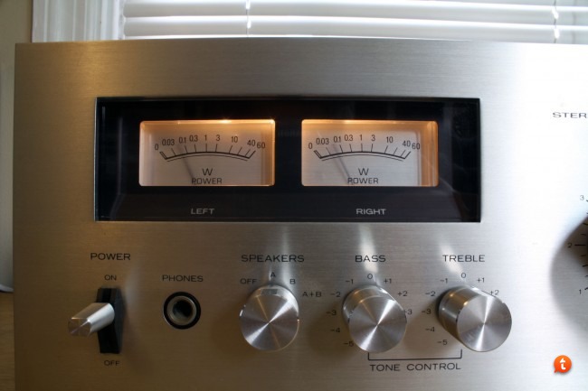

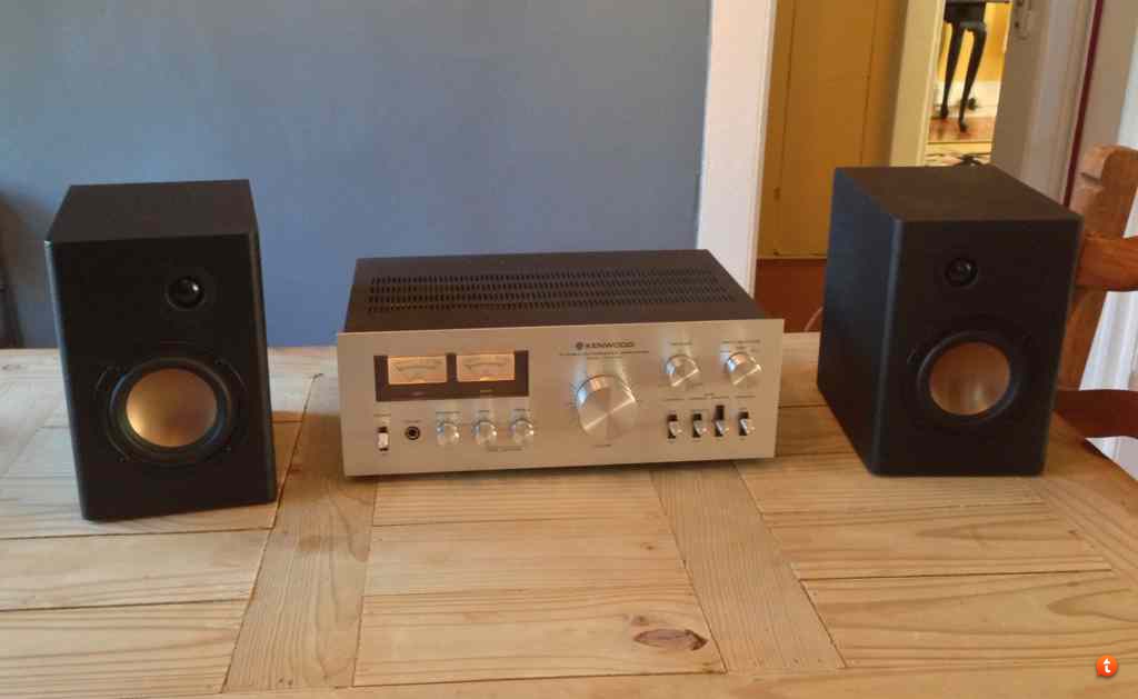

I think this would look cool as hell for your setup...
This is a sweet vintage Kenwood KA-5700 integrated amp, of course there are plenty of others from this era as well to choose from. The last pic is with my speakers I built this year.
I would buy one that has been already "serviced" to ensure best audio quality or bring it to a local hifi shop if you have on near by.

Hey Mark, very nice stuff....

WOW!!!! I use to have a KA5700.. I bought it in Butte Mt in 1979... I wish I had it now. It was a great unit and sounded GREAT/
