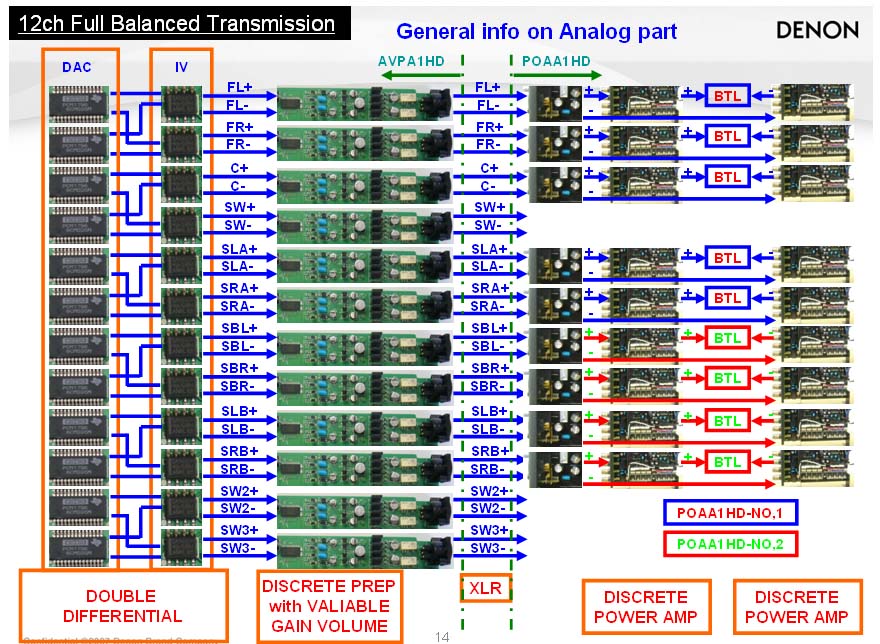

Have you seen the internal schematics for the Denon processor? Everything they sent me indicated the entire signal chain from input to output is differential. Their 10CH amplifier when bridged also is fully differential. I've also never measured a lower noise floor or better FFT from any audio preamp regardless of price. The Denon AVP processor is/was the real deal. They will never make a product like that again.
http://www.audioholics.com/av-preamp-processor-reviews/denon-avp-a1hdci/Denonbalanced.jpg/image_view_fullscreen
Denon-balanced.jpg Full Screen Image | Audioholics
Apologies, I stand corrected. The schematics cover several models on the same prints...it's a bit confusing...the AVR version isn't fully balanced, the AVP version is. My mistake.
