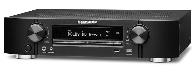

Form Factor: 5 Stars
I've loved the idea of Marantz's Slim Line receivers for a while, but I honestly didn't realize how cool this form factor is until I unpacked the box. Even though a normal-height receiver fits in my entertainment center just fine, the smaller size of this not only looks nice, but it also makes reaching behind it to plug in or remove cables _so_ much easier. As someone who has contorted and reached behind equipment for decades, being able to reach right over the top of this and get to the connectors is simply awesome. The curved sides of the front face are also a very nice looking touch, too.

Overall, a nice solid unit. While about half the size of other units, it weighs close to some of the competition, so it's more dense - and you can feel that when you pick it up. I docked it half a star because the front knobs, while solid, feel a little cheap. The connectors on the back are all solid. As a note, while the speaker connectors look a little fancier than normal ones in the pictures, they are just like the connectors on my other receivers (the Denon push connectors excluded) except with translucent plastic...so not higher quality.
