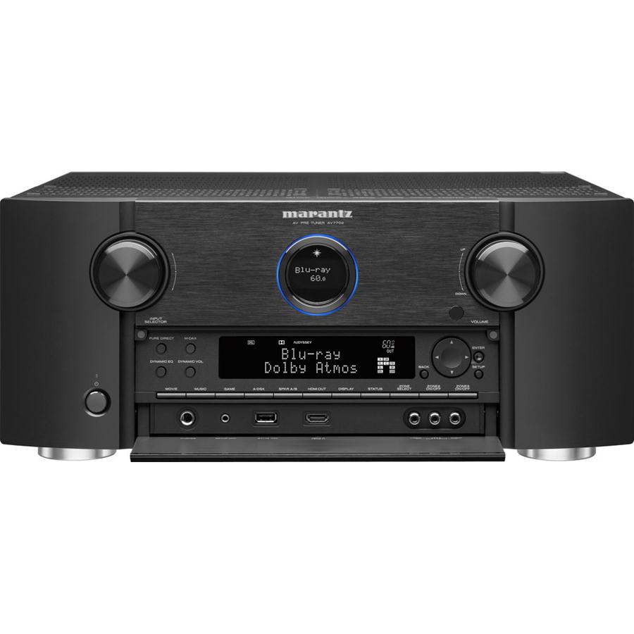

Here we have the newest AV Processor from Marantz to be a Dolby Atmos capable. What do you all think?
MSRP 1,999
what it is and what it does:
Features and Specs

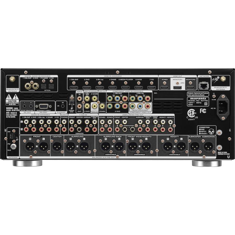

This is not an AVR, but a preamp, correct? I don't see speaker connections on the back of the unit.

View attachment 14310 View attachment 14311
