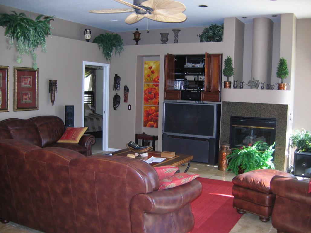

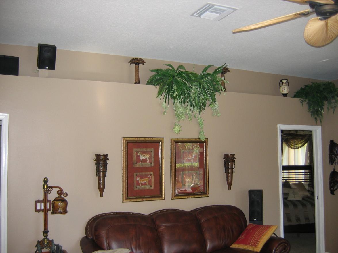

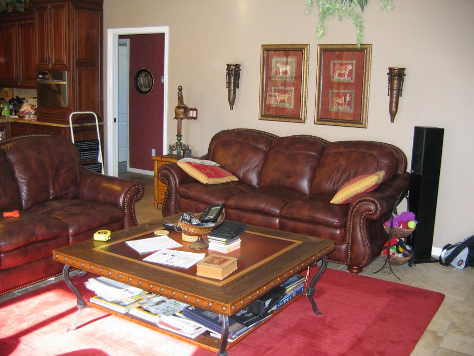

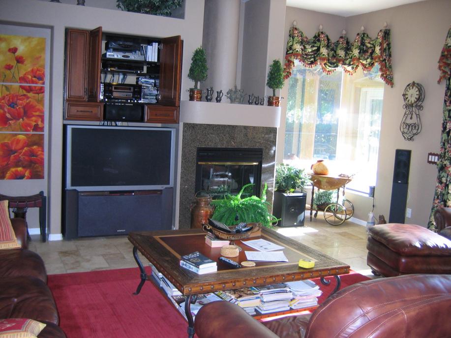

Here are some pictures of my current setup with M&K 750 Select. I will be adding M&K s150 LCR and two M&K K55 tripoles. My current sub is M&K V1250. I would like to add another sub, or sell the M&K and get two subs alike. My current TV will go away and be replaced by an 80 inch. The cabinet above the TV will be placed on the floor where the current TV is and new TV mounted above the cabinet. The left and center M&K 150's will be mounted on the shelf above where the cabinet is now. The right M&K 150 will be mounted above the fireplace in that opening. The K55's will go on the wall adjacent to the couch just below the ceiling.
Need advice on matching another sub to M&K or possibly getting two alike subs. Where should I place the subs? I have an option to place them on opposing walls facing each other.

That wall is tough, how are you going to mount the 80"?
You want the S-150s to be ear level or as close to it as possible, and as close to symmetric with the walls. I understand the wife/SO, walls, decorations and other things need to be considered and what compromises your willing to make. Also, with the 80", your center channel will be fairly high. Careful not to mount the TV too high, remember that it should be fairly close to eye level. A lot of people mount them too high.
The S-150 left I'd put on a stand or wall mount where the artwork is, ear level. The right I'd either use a wall mount with a swivel, ear level again, above where the subwoofer is... or an adjustable stand. The center should be directly above or below the TV, and the TV should be center between the speakers.
For the subwoofers I'd consider HSU VTF-15H's. I think the M&K is a great subwoofer, but for the output required for todays movies I think it will fall short, and to get even room response in your room it's going to be really hard with one subwoofer across those couches.

As you can see, I have a challenge. When I drop the cabinet down to floor level I will put casters on it. I will frame the open area with 2x4's and cover the opening with a sheet of 3/4 inch plywood. Then mount the tv on this just above the cabinet. The only place I can find for the center channel is on the shelf above the TV pointed down at the couch. Now for the other two speakers. I do have stands, but they take up floor space and I have the issue with the door into a spare bedroom being in the way on the left side. What about mounting the left 150 on the shelf and the right above the fireplace on the recessed column? I would point them down toward the couch. I have some omnimounts. Sub location is not a problem as I have room to experiment. But the 150's, are my issue. What effect am I going to create if the are on the shelf pointed down? Or the one in the recessed area over the fireplace?
Really appreciate your help and value your expertise.
If by the shelf you mean the one almost at the ceiling, I think it's a big trade off.... I mean, you have to weigh sound quality versus aesthetics and which you weigh more. S-150s off axis response is good, but, that high is asking a lot. The question is really how much you care about the sound versus the room aesthetics. Or how much the wife will let you get away with. :) And those are all reasonable things to address.
If you can wall mount the S-150s ear level for the L and R, and wall mount the center pointed down at the listening position thats probably the ideal situation that is still relatively piratical.
If you could wall mount the left in that recessed area it would get it away from the wall a bit and clear up floor space. Granted it still sticks out. The Center I'd probably mount right above the TV pointed down, the right I'd side bracket mount as well.
Using the door as a reference, I'm still having a hard time seeing how an 80" would fit on that wall with any reasonable symmetry for placing the speakers.
I admit to being a little stuck for suggestions. I've even considered the wall that adjoins the guest room since that's clean and you could drop wires down that wall...but then you couldn't see the TV from the kitchen and I'm not sure how important that is to you.
Ideal? Nix the fireplace and make the wall flat. Then you can wall mount the speakers on brackets and center the TV.
