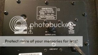

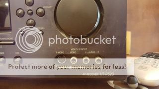

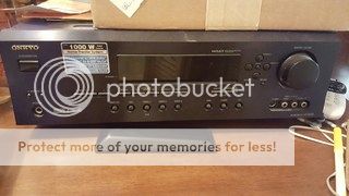

Thanks for the replies. Lots to think about. I'm the meantime here are some pics of the current equipment. Its spread all over the house, installing new flooring. Found a label on the side of the receiver, has a date 08/22/04. This guy has later a long time.
Pictures not too clear. Will try to posted better ones later
Powered sub

Agree about the receiver as long as it has some sort of digital input. Those speakers tho...
The photos are too tiny, but according to online manual (page 8 diagram) I see 3 digital optical input and 1 coax (I think it's 3 total addressable one, not 4)
Still I see both Dolby digital and DTS are supported, which both vast improvements over analog rca.
Lack of HDMI is major inconvenience, but not a show stopper imo.
For the humble budget of $800 sub is no doubt best bang for the buck (literally)
Make no mistake, If you had a LG/Samsung/Vizio or practically anyone else HTIB (except Onkyo) - We'd tell you to trash it entirely. Onkyo did and I think still does just uses full features lower end receivers for their htib systems.

Your Onkyo is fine for now, if you use the digital inputs. If you buy a new receiver first -- then you still have a good chance of being annoyed by the same sub and front channel speakers. Your sub and speakers are limited.
