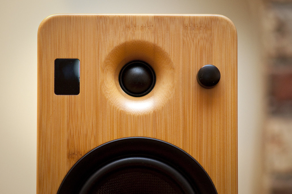

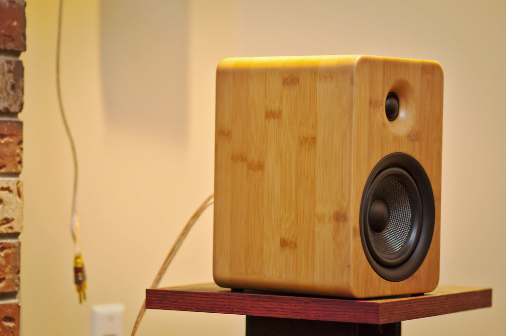

When it comes to looks, the Mackies are in the back of the prom, with stink fumes coming off their backs. A flat back smoothed finish has no business being in the presence of hand crafted, real bamboo cabinets. Really, these are stunning speakers to behold. The bamboo seams and joints are flawless and you never once question the "real" moniker that goes with them. You pay a premium for the bamboo finish, but I will gladly say that you're getting your monies worth. Structure wise, I can't say how well built the Kanto is compared to the Mackie. I will say the Mackies are heavier, and have identical enclosures (you can buy 1, or 5 of the same speaker). I would assume the Mackie is a step ahead as far as internal structure and design, but that will be all speculation until I see insides (I'm not taking them apart, they're not mine). Adding to the cabinets, the drivers are also much more impressive looking. Now, I say "looking" as visuals are not a be all end all for a speaker. A pretty speaker that sounds like garbage has no place within my walls, but I will give credit where credit is due, the drivers (woofers) have a very nice kevlarly carbon fiber look to them, and the clean lines and flush (almost too flush) mounted drivers have a classy look. This is important, as these speakers don't have grills. Although bolts and screws can be done in a way that doesn't detract from a clean look, covering them up consistently and cleanly is easier and makes the package look more polished. The tweeter is a silk dome unit, and it looks the part. I will say that it's anti flush mounted, in the sense that it's actually pushed into the baffle by what I can only assume is 1/2 - 3/4 of an inch. It's perfectly smooth and cleanly recessed, but I wonder what bearing that excessive amount of recession has on the sound. Unfortunately I don't have any recording equipment that isn't connected to a blood supply, but maybe one day someone will take a mic to them. The Mackie tweeter looks identical, but It's probably not. The woofer is a treated paper cone, but the sound of it was out of this world so Kevlar or not, I preferred the Mackies lower half.

Pictures are below.
DSC_7292 by brianjosephson1, on Flickr
DSC_7293 by brianjosephson1, on Flickr
DSC_7294 by brianjosephson1, on Flickr
DSC_7296 by brianjosephson1, on Flickr
DSC_7300 by brianjosephson1, on Flickr
