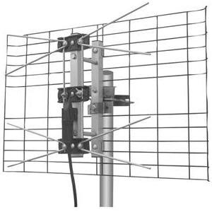

Is DB8e much better than DB8 in all cases?
I am just wondering if DB8e is much better compared to DB8, if a multi-directional feature is not required.
I live in the town just north of Toronto (Canada), so we are aiming to pick up signals from Toronto and Buffalo, and they are coming from almost the same direction. So, it does not look like the multi-directional feature is much of benefit.
My store/installer for some reason recommends DB8. If DB8 works fine in our area, would DB8e work even better and more stable? I will appreciate your advise. Thank you.

Hi Laval,
Based on the many positive reviews of the DB8e, I bought it as a replacement for my Channel Master 4228HD, thinking it might help pull in a few Buffalo area stations that come and go. I'm located in North York, so my experience might be relevant to your situation north of Toronto. I actually found that the DB8e pulled in fewer stations than the 4228HD. Not including sub-channels, I was at most only able to get 22 channels with the DB8e, whereas the 4228HD hit a maximum number of channels of 31. I had them both on the same pole, pointed in the same direction, swapping the cable between the two. Also, I used a 7777 Titan 2 pre-amp during my testing. Given the very big price difference between these two antennas, I'm kind of miffed that I forked out $199 for the DB8e when it looks to be less effective than my $80 4228HD (both purchased at Angel Electronics in Mississauga).
