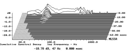

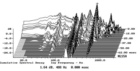

Take, for example, the Primus 360 an all around superb speaker, but it uses typical bracing techniques and has a fairly large radiating surface area [cabinet]:
Please note that Stereophile does not take into account loudspeaker sensitivity when measuring resonance. So, if comparing a loudspeaker with sensitivity 93dB 2.83v/m such as the 360 to a loudspeaker with sensitivity of 90dB 2.83v/m as the 802D the resonance plot of the Primus 360 would need to be dropped 3dB to be compatible to the 802D. Because of this I will note all compared sensitivities above the graph.
[93dB 2.83v/m]
These resonances are not just audible, but would be extremely detrimental to sound quality for nearly all types of source material

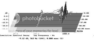

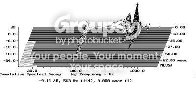

The Revel Studio2 [88dB 2.83v/m]:
Not only does this unit is far more extensive bracing than typical, it also uses thicker walls [fairly inefficient, but better than nothing]. As seen, these resonances are far lower than is common in most loudspeakers, but will occasionally be audibly with the right source material.

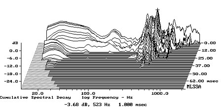

B&W 802D [90dB 2.83v/m]:
This unit uses an extremely complex bracing matrix as well as a specialized mid range enclosure that is absolutely inert. No audible resonances would be observed. Please note that there must have been some other vibration creating the peak centered at about 50Hz as it is not physically possible for this unit to resonant at this frequency with its internal structure.

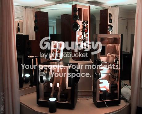

This is an example of cabinetry that was built to be as resonance free as possible...from Aerial Acoustics. You can see from the cut-away picture the lengths to which they went to fight this form of distortion. Two inch MDF walls, isolation chambers, rigid bracing, etc. have provided an almost inert cabinet setup.
And here is the result of AA's effort. This is from Stereophile. Examining the panels' vibrational behavior of an Aerial model 7B (front right in above picture) with a simple plastic-tape accelerometer revealed some resonance modes, but these were pushed high in frequency by the bracing. The figure below is a waterfall plot calculated from the accelerometer's output when it was fastened to the cabinet sidewall 12" from the floor. A single mode can be seen at 563Hz, and could be found on all surfaces. However, the fact that it is both high in frequency and low in level means that its subjective effect will be minimal.
This kind of over-built construction design is one reason why some of the better speakers also cost more.

Wow those are heavily braced cabinets. I see that even the Model 5B which is their cheapest speaker has very extensive bracing and uncommon for a speaker in it's price range.
