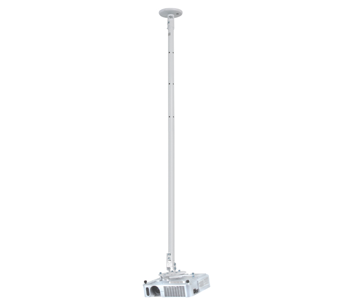

agarwalro
agarwalro
You could use a long drop projector mount with sufficient weight capacity.
