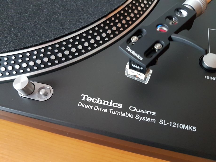

Would anyone care to comment?
I suspect this is a wrong way to tilt the needle, it'll only get "slapped" on the outer side?
This TT is for sale in the hood, so I was wondering would this operating "mode":) leave some lasting damage?

Yes, it will cause lasting damage. However when you buy a used turntable, unless you have an operating microscope to check the stylus, you always need to replace it. A new stylus for a Shure M44 is not a fortune anyway.
While you are about it, you might want to treat your self to the top end Shure cartridge.

:)I was kinda hoping you'd answer. Thank you. I meant other than cartridge, will anything else get hurt?
I read elsewhere you recommend Shure and it's at the top of my list. I have some reading to do on compliance, though.

Nothing else will be damaged.

I doubt it will be good for the LPs, but that's about the only damage that will occur.

Did this TT ever see any DJ use? (i.e. scratching)?
I good clue would be if the seller actually has a pair of these.
But, at least that stylus doesn't look like the typical choice for scratching, so likely OK.

@highfigh @slipperybidness Thank you, guys.
I'm not trying to save this particular needle. They are expendable any way. I was interested in the head shell and the rest of the electronics.
Yes, he has two of them. If he did some scratching, same question, is it dangerous just for the cartridge or more?
As @TLS Guy said, decent cartridges don't cost a fortune.

Well, I own an SL1210, and I can tell you with certainty that these things are built like tanks! To my knowledge, scratching is only really bad for the stylus and the vinyl. So, it may not be a deal breaker. In general, do these look like they have been well taken care of?
Do you mind telling us how much he wants for 1 of them? You may be able to use that DJ use to your advantage to get the cost down.

I would be very hesitant to buy a direct drive TT that has ben used for scratching. Probably doesn't damage the motors, it's just the idea of stalling the motor and forcing it in reverse repeatedly has me thinking "heat to the windings" that isn't what they were intended to see.
I'm very likely WAY over-thinking on that because I don't know squat about any of it. ;)

Well, on the Technics, the platter is an integral magnetic part of the motor spindle. So, you are not really mechanically turning the motor backwards, only the decoupled magnetic spindle.
But, to be honest, a lot of DJs will also have a "slip-mat" and that will help decouple the mechanical motion too.
All I'm saying is that DJ use does not rule it out, but I would certainly try to use that as fodder for price negotiation.
