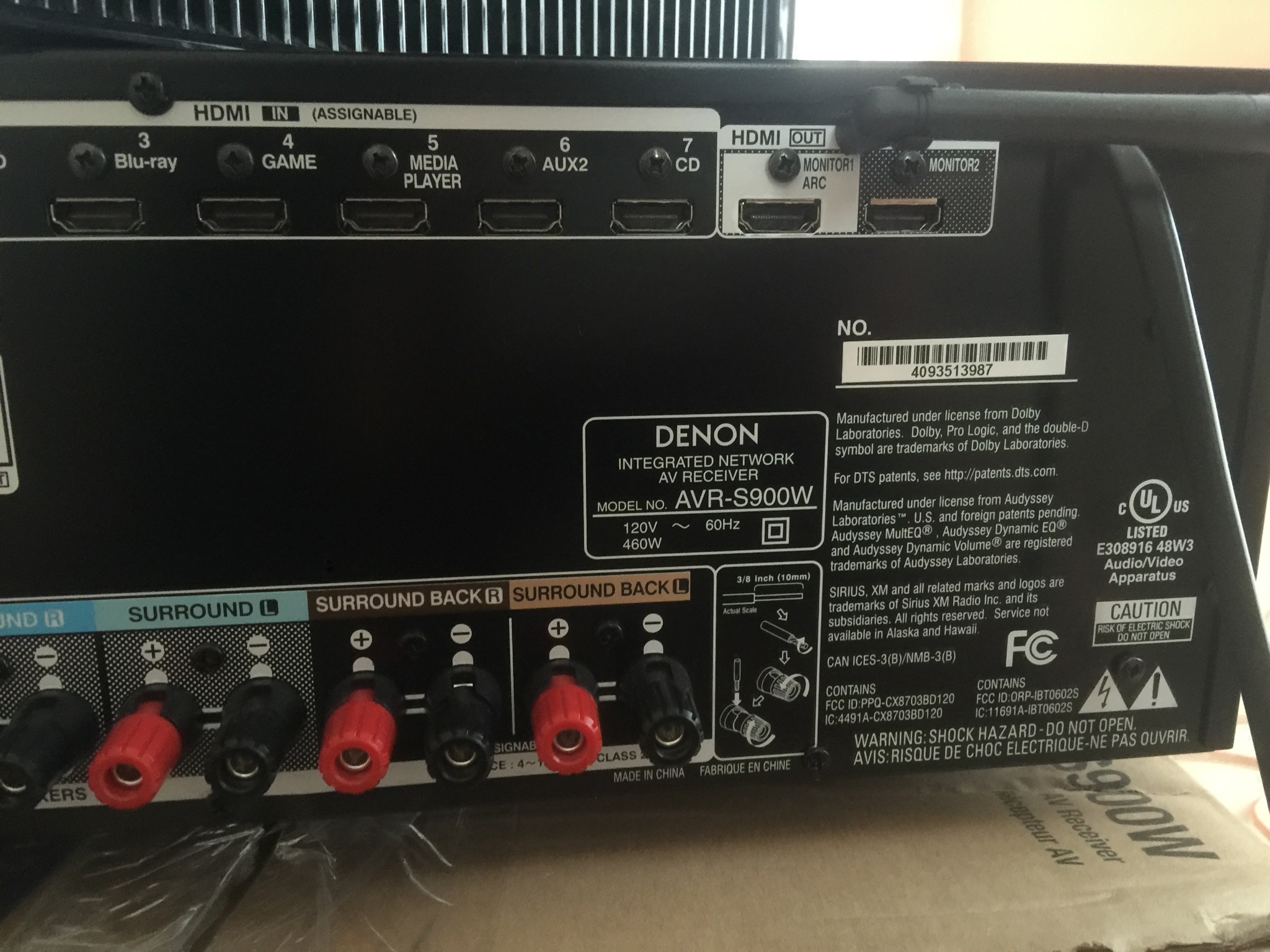

I do have both of the gold plates I just only put one on for the picture.
I uploaded pics of my reciever- it has a pre out and I THOUGHT I might be able to connect an amp to that but let me know if it is possible with this receiver. Or adding an amp through any method.. That is if adding more power is going to make a difference..
Supposedly it is 100 watts per channel and is a 7.2 seven speakers and one sub out and one pre out so total 900W combined
Denon AVR-S900W
Thank you fmw!
F
fmw
The preouts are for subwoofers. They provide a path to bass management and you should use them with one or more subwoofers. But they aren't appropriate for anything else. Your receiver doesn't have what is required to use external amplification. Probably not a big deal. Hook up those gold straps and enjoy the system.
