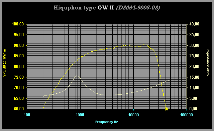

As far as I know, the standard SongTower tweeter is the Hiquphon OW2, see Hiquphon's frequency response and impedance curves, where the tweeter's impedance peaks at 800-900 Hz, near it's resonance frequency point.

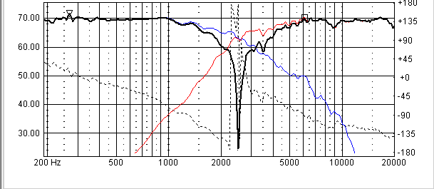

In the ST, the crossover is 4th order LR, at 2.5 kHz. This "Reverse Null" plot shows the simulated frequency response with the tweeter's polarity reversed.

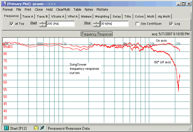

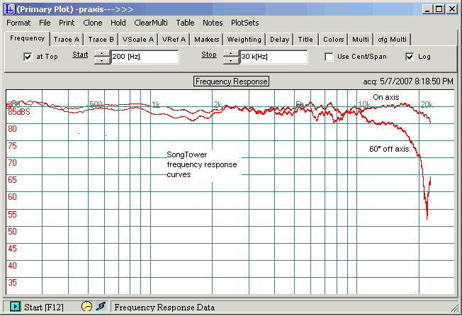

And this frequency response plot shows on-axis and 60° off-axis plots. The on- and off-axis responses of the woofer begin to separate in the 1-2 kHz range, as the 15 cm woofers begin to beam sound as the frequency increases. At 2.5 kHz, the crossover frequency, the two FR curves coincide as the tweeter operates. The two curves diverge again as the frequency gets higher than 5 kHz.
Odd that the impedance peak is 1000 Hz before crossover. However the crossover is second order electrically, as you can tell from the pictures. However both the woofer slope and the tweeter slopes are second order, so when you combine the two you get fourth order. So the tweeter power would be 18 db down by resonance, and so the speaker would handle 100 watts as far as the tweeter is concerned.
