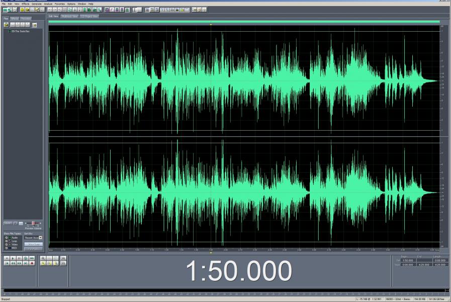

Playing Partrica Barber's Swim at a good volume upsets my Right Salon 6.5 mid-Bass driver.
After swapping the preamp outs and amp outs the problem remained in the right channel.
I am playing the 24/96 HDTracks FLAC file and the midrange losses it a few times between 1:50 and 2:00 minutes.
A friend did an analysis of the audio and it has about 24 DB dynamic range while playing this section.
That would indicate a power spike of about 100X. He has old radio-shack meters and the go from about 1 watt to 50 watts driving his monitors.
I was playing at -15 via the HA-1 connected to the A51 amp.
There is no problem I can detect at moderate volumes but it wasn't too expensive so, I ordered a replacement.
Here is an look at the FLAC file:
- Rich

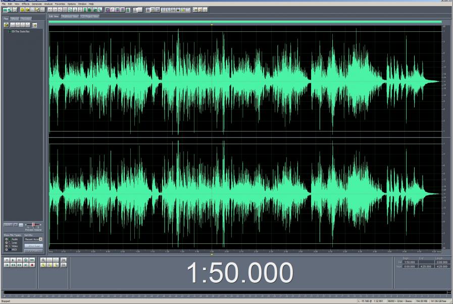

- Rich
