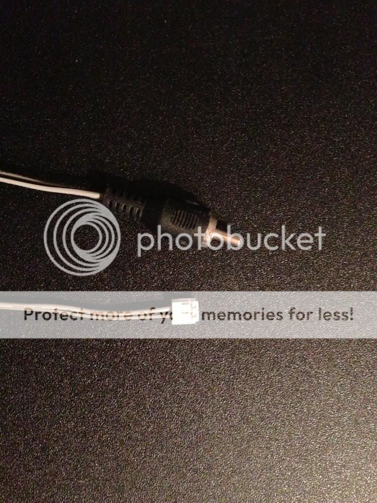

The sony subwoofer came with a sony stereo set (two speakers, receiver/tape/cd player, etc.). The sony receiver went out and I'm looking to hook this up to my sherwood receiver. However, the sony subwoofer has two wires coming out of it. One wire is the subwoofer jack and the other appears to have a "+" and "-" component with a special sony plug (that only plugs into their receiver). Can I cut off their special plug and hook it up to my sherwood receiver?

Does your Sony sub have a separate power cord? I'm wondering if it is a passive or active sub. After we know that, we can answer your question.

It doesn't have any other cords or a separate power cord than what is shown in the picture above. The model on the sub is ss-wg750. Thanks.

It looks like you have a passive sub [no built in amplifier] that doesn't allow you to run the speakers threw it. The only way to hook this up to your receiver would be to buy an amplifier to use along with it. I would strongly advise against this, as buying the cheapest powered subwoofer you can find will almost certainly be an improvement over the one you have.

So, what exactly are the cords pictured. I have the opposite issue. I've got the Mhc-gx750 stereo, and am looking to hook up a sub other than the sa-wg750. Is this possible?

Well, I've got a SVC passive sub. I'm wondering if I can hook it up to this stereo. The original sub that came with the stereo had these 2 plugs(the ones the op pictured above). Which plugged into a subwoofer out port and a subwoofer control port. Seeing that my sub doesn't have those plugs, is there a way to hook it up at all? Why would the original passive sub need these two separate connections?

Ok, I appreciate the help. I am just doing a hack job setup with piece and parts I've already got for in my shop. I played with it a bit more and ended up horse shoeing the so called control. It must basically complete a turn on circuit when the original sub is plugged in. And then and only then will send power through the RCA. I've got it working. Thanks.
