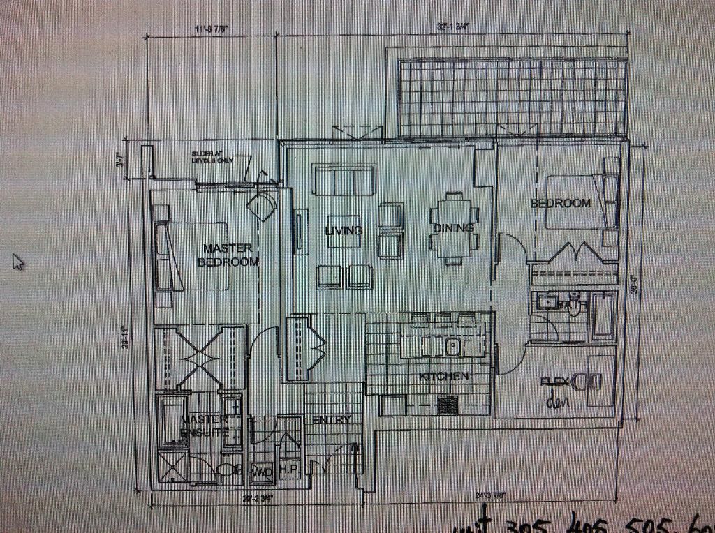

Hi everyone, a friend referred me to this site and i am new to this forum. i signed up to learn more about a/v equipment as i dont know too much and im hoping to get some advice on setting up a home theater. i just got married a few months ago and our new condo should be completed sometime this month. im in charge of putting all the electronics together for the new place while she deals with the furniture so i guess its time to start making some purchases.
ive attached a floor plan to the condo below and im thinking to place the home theater system to the left of the word LIVING. the top section of the floor plan (where the balcony is located) is facing east and that whole east facing wall is floor to ceiling windows. according to my rough calculations, the whole open area where the home theater system will go and which includes the living room, dining room, kitchen and the entry way comes out to approximately 560 square feet. the ceilings are 9 feet high so the total volume is 5,040 cubic feet. please correct me if i calculated incorrectly. also any alternative suggestions on where to setup the home theater would be much appreciated.

I would try and go for at least $2K budget for the speakers since you probably spent $1K on the AVR. The rule of thumb for HT is about half the total budget on a sub or subs since this is the most important part of the HT sound. Spend as little as possible on the AVR when working with a tight budget.
So with $2K for speakers I would look to get a pair of SVS PB1000 subs at $949 shipped with a 45 day in home trial and free return shipping if you don't like them.
Leaves $1K for 5 speakers. You can get some Ascend Acoustics or HSUs in that budget, maybe some Klipsch Reference series if you like the Klipsch sound. They will sound better than what you demoed.

I'm the friend of JikJak that helped demoed the speakers. I'm of the opinion that a much better bang for the buck can be had for if he goes towards used speakers. So far, I've been seeing used speakers going for about 50% of the MSRP of new ones.
My new recommended setup would be the PSB 6T, 9C and matching bipolar surrounds with an SVS SB NSD 12. I would think the PB 12 would be a better fit for the usage but it's too big for WAF.
Considering a 50% discount on the 5 speakers and no discount on the sub, would there be any other recommendations given a $1000-1500 budget?

Welcome, and good job Bloodstriker with the recruit, now that hes hear there is no leaving :eek:...
First for the budget, I am thinking $2000 because trying to get everything for $1000 including a sub is tough..
I would look into the PSB's with the sb12, while the sb12 isnt HUGE on output its still a capable sub and nice and small..
i tend to prefer strong and tight bass
1) The "volume" is affected by the speaker channel levels in the AVR and speaker sensitivity (90dB vs. 85dB). For example, if the speaker channel levels were set to -6.0 in the AVR, you would have to increase the master volume more. If the sensitivity is 85dB/2.83v/m, you might have to increase the volume more. But it doesn't mean the speakers cannot play loud enough for you. For example, increase the speaker channel level to +6.0 and see if the speakers sound "louder".
2) The room size will affect the subwoofers, but it is the actual listening distance that affects the speakers. For example, even if you were outdoors (infinite space) you can still hear the speakers just fine depending on the distance from the speakers.
3) "Weak" and "hollow" sound may just be the lack of good quality punchy powerful subwoofer bass, not related to the actual speakers.
