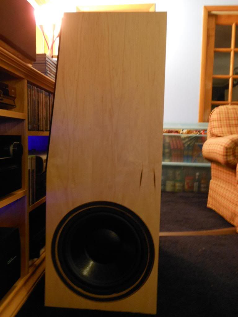

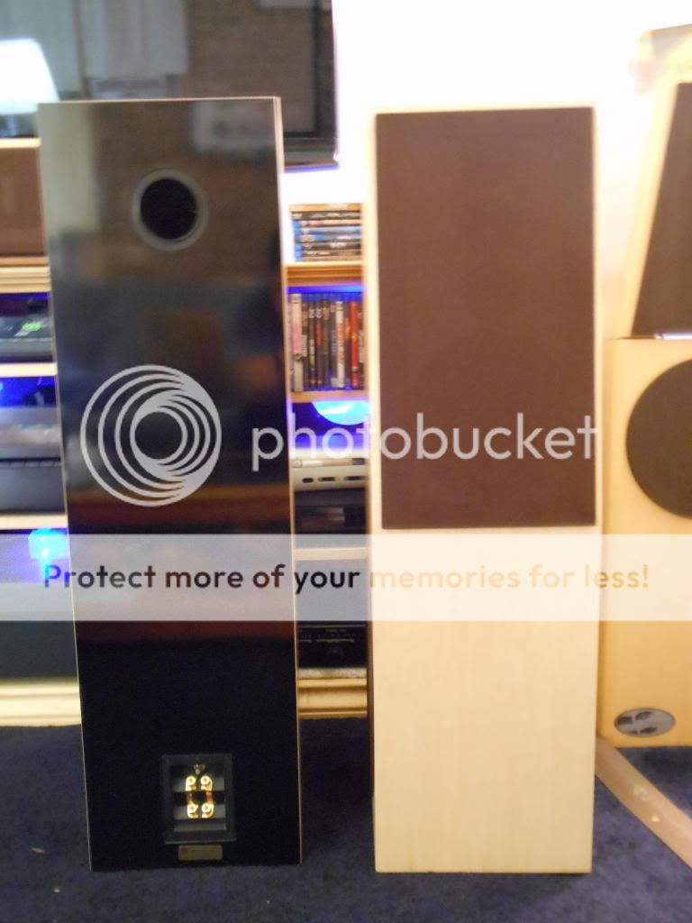

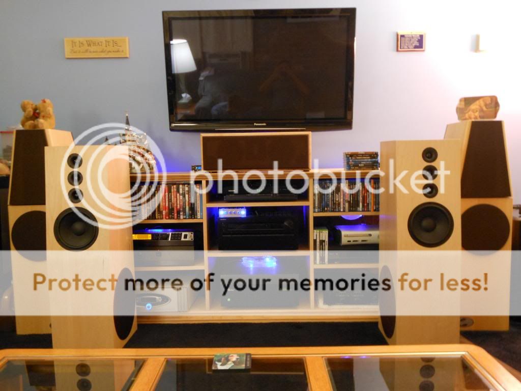

Are there any other options that have built-in subs and 8 drivers? The Infinity speakers are also active and 4 way but I don't think I'm going to find anything that matches all of that.
These are a pair of towers I have. Triple tweeters, 8" mid woofer and built in 12" woofer/subwoofer.
