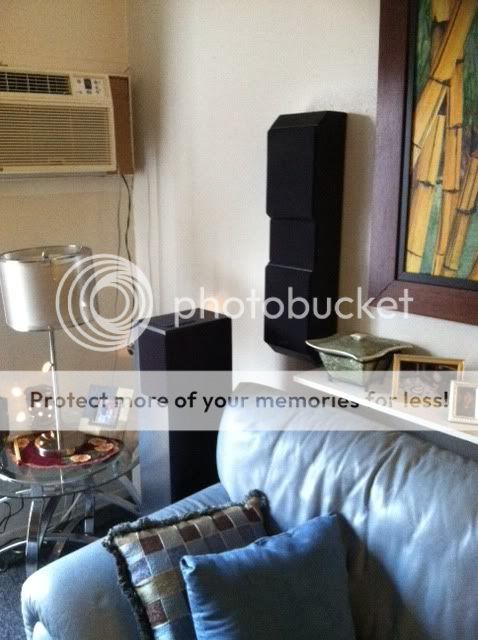

What I used was Monarch Z-clips Monarch ZClips | Panel Clips for my rear surrounds. They can hold a ton. My rears weigh 24#. I only used one clip. You can also buy them at Home Depot, just ask for french picture hangers. All you need to do is drill 2 holes in the back of your speakers for one mount. It took me a few years to make that decision since they are $1800.00 a pair but I am glad I did. I also put 4 thin little rubber stick on feet on each corner so they are thight and streight. Very easy to mount.
