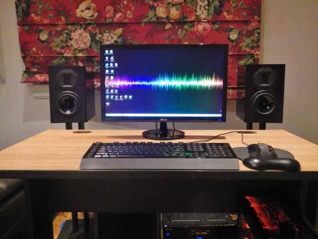

Something I think is important to note is that the CSB-1s gave me hell when trying to get them to where I really wanted them to be. I took about 5 days of moving things around inch by inch while spending about 40 hours total in REW doing sweeps and real time analysis. Granted, most of that was me learning how to do all of that stuff in REW. I feel like the upper midrange/treble of the RC-10s, while not as detailed, are easier to get good results with. That might stem from the fact that the RC-10s have a flatter midrange/treble. Also its important to note that I am not running the CSB-1s flat, like all of my speakers I prefer to apply a house curve(+1.8dB/octave starting at 200hz and -1.4dB/octave starting at 2,000hz). While I was messing around with the house curve on the CSB-1s I thought about the CBM-170's. I feel like I might have been able to get them where I wanted using all this new tech I have acquired. They were really missing that lower midrange and I feel like a house curve might be all they needed. Flat frequency responses tend to not sound so good to most people(see Harmon, B&K study etc), any that might have been the issue. They were too flat, something that I could easily fix now that I couldn't do then. Alas, I will never know.
So after 2 months, 5 speakers and about 40 hours buried in software - I am content.
Note: After analyzing the CSB-1s with all my new gadgets I decided to go ahead and put them on stands behind the desk as some previously suggested before. In the end it was not so much that they measured better from there; the difference was slight, I did it more for the vast improvement in sound-stage.
C
cschang
I wouldn't think putting the speakers on stands behind the monitor would help much.
You should try and mitigate the reflections off of the desk, and move the speakers' front baffles in front of the monitor. That would give you the best sound, but I realize in a desktop setup, that is easier said than done.
2
2ndammendment
I ran real time analysis, room sim and did many sweeps. I tried just about everything I could think of over the past 5 days and they ended up there because its what gave me the best results.
