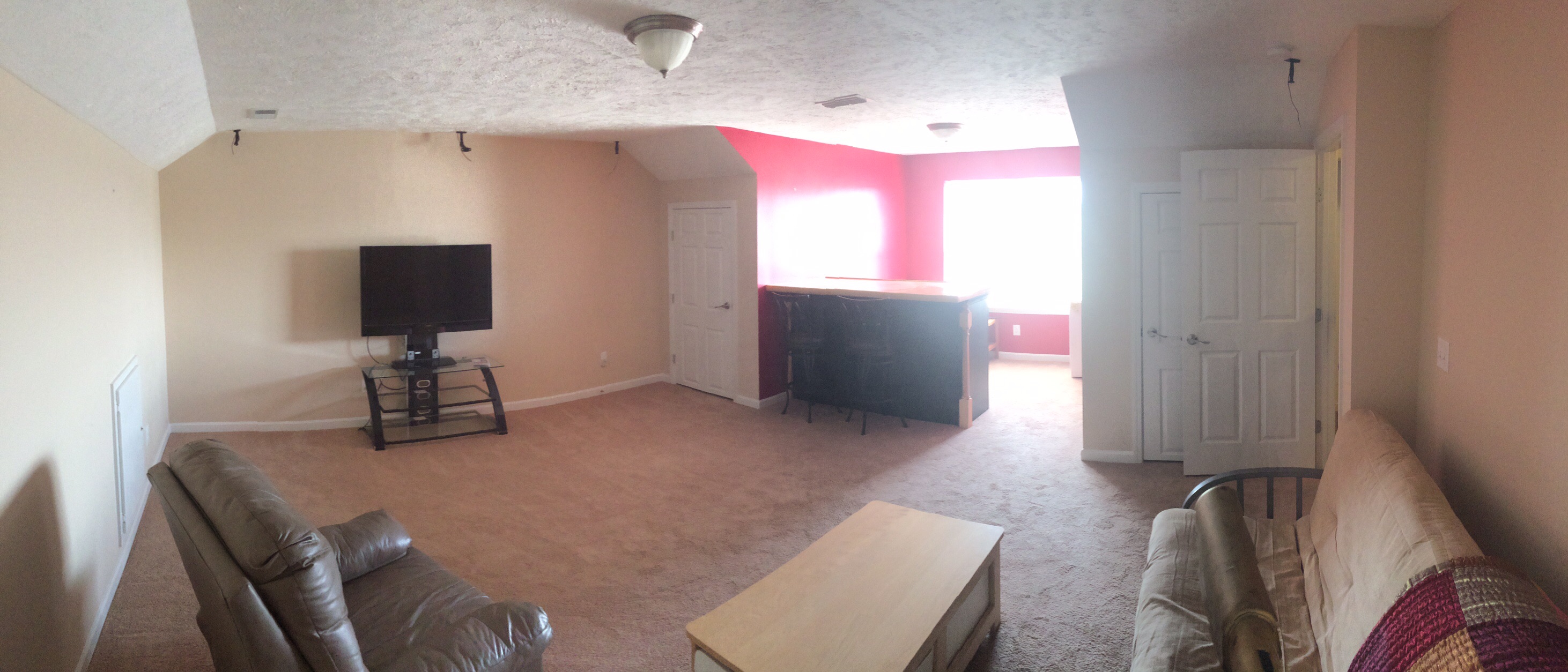

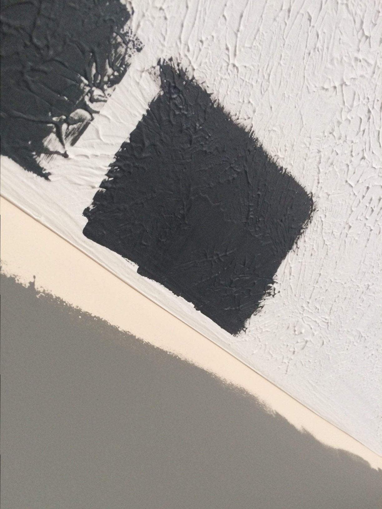

My room is a dark grey and the ceiling will be darker (pic attached) I have one window and can conceal most of the light with blinds/curtains. I've artached a couple pictures so you have an idea. I'm even thinking about putting curtains in front of that nook and separating it off which would help more. I'm also hoping to redo the lighting and put in recessed lights and my projector will go roughly where the dome light is.

If you are working on the room, I would look at moving the speaker locations (ask in the audio section).
Dark walls, dark ceiling, subdued or non-existent side lighting and directional lighting...
Get a white screen.
