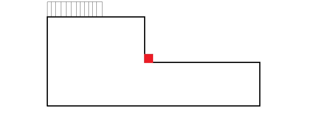

    Here is a really bad MS Paint drawing of the basic idea looking down on the room.
    As you can tell though, it is a very large, very open area. Along the longest wall is windows, and a door to the back yard so the TV cant go anywhere along there. So looking at the drawing, the TV can go on the right side or the left. Technically it is set up to be split into two rooms (living room and dining room) but we have no desire to do that, so it can be a very long space for me. What I cant decide on is if I use the length of it all how will it effect my sound being that its wider on one end than the other? What seems best to me is to put the TV on the left side toward the bottom, put the couch even with the column (in essence split the rooms), and surrounds on the side walls up high (at least 9' since the kitchen has 9' ceilings). That would put the left front speaker in a corner, and the right out in the open. Also I would think I can only really do 5.1 in that configuration. Ill just leave that as my only configuration for now, and let the experts chime in.

    In my honest opinion, it takes a lot effort to try to guess what exactly you are asking. I mean, shorter part of L is already a tad bit confusing (I'm afraid of wasting time and breath by diagnosing a total misunderstanding), but this is even more hazy to me: What I cant decide on is if I use the length of it all how will it effect my sound being that its wider on one end than the other?
    Ok I think I understand this (except what you mean by splitting rooms), but then you lost me again with left front speaker in the corner, because I thought it would have been the right one!?!? Argh. But wait weren't there windows there you didn't want to cover? Argh. I'm already confused, and don't want to try reading a third time, I don't get paid enough. :cool:
    Just how many windows and doors along the longest wall? (Pics are worth thousands of words).
    My instinct it to set the TV up on the extreme right, with viewers facing east. Yes, you may have to deal with light reflections off the display, but it seems to me that cannot be avoided anyway unless of course you might be blocking the windows/doors which you said can't happen?
    The reflective energy/balance will be more even between left and right sides. Boundary gain/effect of side surrounds may or may not be more even. Using greatest length as orientation has the benefit of least modal issues for listeners.

    There is a drawing of the room... Here it is again just in case
    If that doesn't work for some reason, think of it like this. On the left you have a larger box, say 20x20, and on the right you have a narrower box that is say 10x20. So the bottom edge would be 40' long total and that is the outside wall which has windows and a sliding glass door on the right side. So since I wouldn't want the couch in front of the sliding door, that would mean the TV would be there and the couch would be on the far opposite side. I see two problems with a lay out like that one is how far from the screen we would be. What I was more asking though is since the front speakers are in the area that is 10' wide, meaning that is as far apart as I could possibly get them, and I would be sitting in an area that is 20' wide and 40' away how bad would the sound get screwed up (or would it really at all)?
    SO the other option that seem to make more sense to me would be to position the couch at the (non existent) seam between the "two boxes) facing the left wall (larger box area). The problem I see with that is one speaker is in a corner and the other is open on the side. Also I really only see two surrounds on the side walls up high. I could do two more behind the couch, but that would be about 10' away and I don't know how that would work.
    Mull that over and let me know if it makes more sense, and if the drawing is showing up to help out.

    I don't quite make sense of this. By "there" you are referring to the sliding glass door? You must be referring to some unnamed thing, because I can't imagine you blocking the door with the TV. "Far opposite side" has me guess that you were trying to impart the idea of a west-east sort of orientation (maybe east?), but your description is still not clear enough at all for me. edit: Ok I think I might understand what you're trying to say now . . .
    Ok, it DOES look like we want to talk about the same setup, facing eastward, the viewers I mean facing eastward. I don't see any issue (save for one, will address in a second) with being in a wide area when you are that far back; I believe the left/right balance WAS a greater issue, but now that I think about it, if facing westward, and you were given quite a bit of freedom in pulling the speaker out from the corner, then I might go that route. The boundary imbalance will be mitigated, and 10' with the other way is kind of getting a little tight for three speakers. Perhaps the boundary balancing is simply balancing too much boundary interaction from both sides to begin with.
    If you still go for the eastward route, but want to sit THAT FAR BACK, the issue IMO is simply the SPL levels. You would need some big and very ugly commercial/pro type speakers for anything resembling movie theater levels. Now if you just don't need that, then you don't need that, but 40' is a huge length. SPL drops exponentially with distance. I've seen some pros think that once at the around 25' or so, you need upwards of 20K to make it work, dunno how true that is, but distance is an issue that way.
    Too high is definitely in a compromise, you will for sure want to angle them as much as you can. You know how I feel about the corner. The further away you can get, the more I'm okay with it. You know what you ought to do is just throw the speakers in both locations and give it a listen. That's the best way, only YOU will know exactly how far you are willing to place any given speaker from any given boundaries, and then you can listen to that result. It will for sure be a lot more tamed once all the furniture and materials are brought in, but you'll still get a much, much clearer idea. I simply assume acoustic panels and bass traps are simply a no go here, but if I'm wrong about that, the corner becomes less and less of an issue. It might not be bad anyway, and some people are pickier than others, some people imagine things more than others . . . let us know how your experiments turn out.

    I was talking about blocking the door, well actually the fixed glass side. It was never much of an option, but if somehow it would work out better than I would be OK with it.
    So at the end of this, it looks like viewers facing east is the best with the seating in the middle. That would put the seating position about 20' from the screen, and allows speakers directly to the sides, although somewhat high up. So now that we have the basic orientation figured out the first question is do I just do 5.1, or add two rear backs for 7.1? The only issue with rear backs is that they would be probably 15-20' away from the seating position. I really don't know if I can adjust them to be even with the rest of the system being that far away, or if it would be worth it. Then my next question is what type of surrounds should I use? I feel like Di-Poles would work best on the sides since the would be close to the seating position side to side (but up high). Then IF I ran surround backs seems like just a bookshelf type to point them directly at the seating position.
    So the layout is not ideal, but even worse is no treatments, AND the wife wants hardwood floors. Home Theater is one of many hobbies, and the race car pushes the boundaries the most, so I choose my battles in that arena :) So the home entertainment will suffer some from room layout, and treatments, but I want it as good as possible with what I have. Next house will get a dedicated room, I promise!
    Sean

    I don't know how you came up with the middle being the best. Read on.
    Perfectly middle is about the worst place you can place yourself, though because it's not a perfectly symmetrical room, I suppose that may not be absolutely true, but it will be pretty close enough anyway. The usual place to start in the symmetrical room is 38% room length. Frankly, I'd get a lot closer than 20' if were you for a number of reasons. The SPL thing I covered. Unless you have a projection system, and not just any projection system, a really freaking huge one, you will be nowhere near resolving HD with the display. A third reason is that you will not get nearly the necessary spread in speaker for the "stereo width" that can make one system achieve a whole other level that many/most don't (by moving forward, this angle is incidentally increased). I suppose a 4th reason is that you have more liveable space in the area behind viewers, I suppose, depending.
    One thing I don't like about dipoles in your case is that if ever you decide to change things up, placements, positions, anything, the compromise will be less forgiving, I would imagine, with dipoles. Rear speakers, so far away, I wouldn't if I were you because in your case the benefit:ugliness ratio is probably not worth it. I wouldn't, and I say that as a current 7.1 owner.
    I personally think too much credit is given to carpets vs hardwood. The floor is only one boundary, for any given (typical) room there still are 4 walls and a ceiling, so it's only 1/6 of the equation so to speak. Then carpet, curtains, whatever, are a very long shot away from being broadband; they only absorb HF, and even then, it's only some random subset of the HF depending on the actual fabric. IOW, I will take well placed speakers with hard boundaries everywhere, over compromised placements of speakers/viewers with carpets and curtains, everyday of the week, and twice on Sundays.

    Nah, that was ignorable, I was just explaining what I meant but also saying it isn't an option anyway. So we will just drop doing anything in that area all together.
    Well actually I changed my mind after my post last night, and came to the same conclusion you did. For room function, layout, viewing distance, and so on it would be better if I move the seating further forward. Why I was thinking of putting the seating in the "middle" was because then I have two evenly spaced side walls for the speakers. If I go forward it poses a problem of having the south wall close, but the north wall very far away. One other advantage of moving the seating forward is I could also shift everything north into the center of that area. That still poses a problem for the north surround speaker though. Remember the north side of that area is the stairs and the entryway.
    I will have to look at that closer next time we are there which is this coming Wednesday. When I get out there I will get actual measurements and pictures to help this all along.
    I see what you are saying with the di-poles as well. Again, the thought was that the side walls would be so close to the seating area that it would help to make the speakers location harder to pinpoint.
    That makes sense, I never thought about it that way. I am not overly concerned with the floors, like you said placement and adjustment are more important AND something that can be controlled. Just the fact that I will have a sub, and a full set of speakers is a big jump from what I have had the last few years. If I am giving some up because of the room, and the floor it is something I can deal with. I am really just excited to have a damn sub again! That SVS Ultra is getting ordered the same day as the closing :)

    Yes, if you ARE going to do the eastward setup, you know I heartily agree to scoot up WAY closer. However, if 10' is in any way accurate for the width you have to work with, I have some serious reservations. Because opposite setup, westward: If you can get better width, say roughly equilateral triangle with listener as a starting point (I never had any system set up further than that, but I have heard one system that was much wider in fact, and imaged like super crazy), and if you can pull the "corner speaker" further from the corner, then I might consider that. Yeah, ok, your right surround speaker is an issue. Only you can know, like I said. But, I will take the perfect front 3 with very compromised surrounds, over perfect surround with very compromised front 3.
    Anyway, re eastward, the proximity of surrounds, obviously if one person, +5' each way should be plenty. But, how many viewers wide, for instance, how long is the couch, etc. Well even if pretty wide, my guess is that the surrounds will be just fine even as monopoles, because as they will be up higher; I think the distance is going to be greater than what you're probably accounting for.
    One thing you might benefit from the wood floor, as you seem to be really itching for LFE, is that you'll probably get more tactile feedback with it than with carpet. :p I'm going to make a dumb guess here that your wife has absolutely no idea how huge that SVS is though. I'm just preparing you for her reaction. :D
