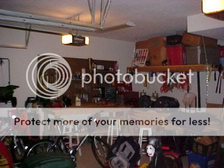

I handle my garage like I do my cable management:D But you could make a hanging shelf.
eye hooks in the ceiling connected with chains to 3/4" plywood on 2x4 frame. Make it any size
and use it to also hang things from. And it looks more manly then kitchen cabinets:rolleyes:

That looks like my living room back when I was single minus the doritos.

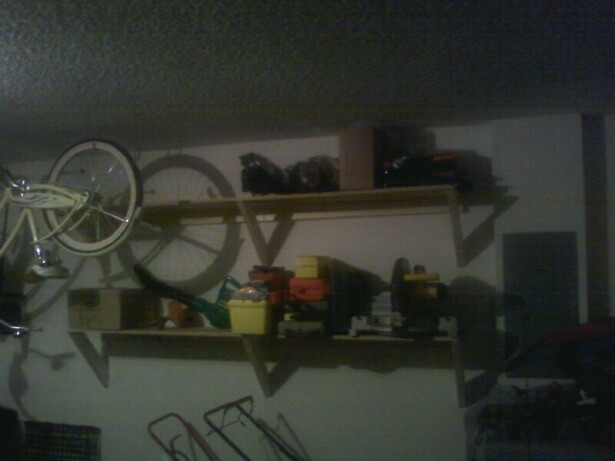

Well I went to Lows and bought a handful of 2x4's and a 4x8 sheet of plywood. I got 2 shelves up and 2 more to go. Pretty pleased with the way it came out. Thanks for all of your inputs.

Post some pictures. This may be something I would like to do in my garage.

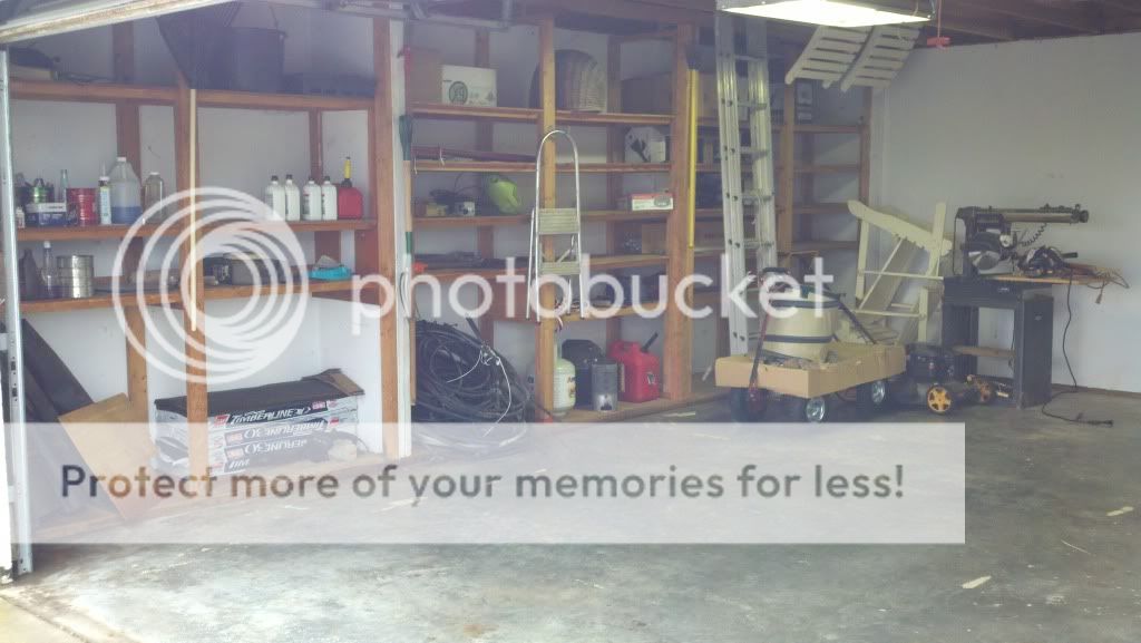

My garage. These were already there when I bought it, but they work out nicely.
