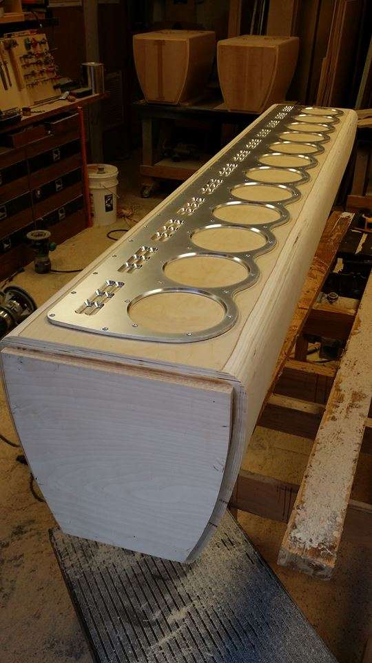

Process: The beginning of the build
Two more years of digging around on the forums and finally getting projection. I finally decided to give Funk a go. The second visit was in June were I demo’d the 8.2Ps as well as the 6.1Ps. I was going to use SEAS drivers & Fountek but have decided to use Nathan’s Drivers because of their performance.
After a few times of changing things here and there and causing a heck of a lot of trouble I finally decided on what exactly I wanted. All these extras are to get the best. Curved cabinet, Faceplates. Koa for the top and bottom to tie everything together. I decided to grab the Subwoofer as well from Nathan since the Arrays are going to need something that is worthy of keeping up. Knowing what I experienced 2 years ago certainly was not something I would forget.
After about 3 months, they came in.

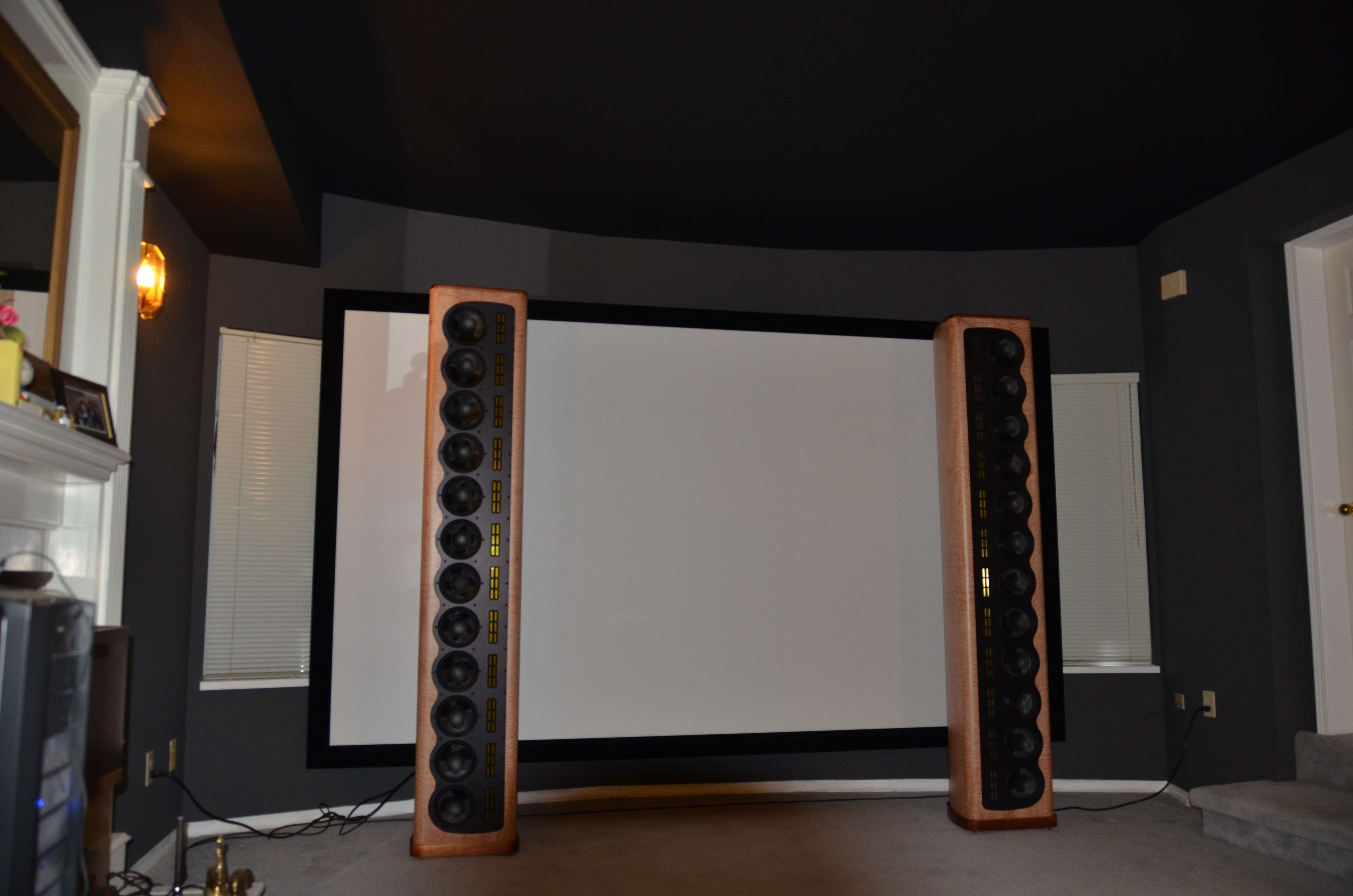

Visual & Physical Impressions:

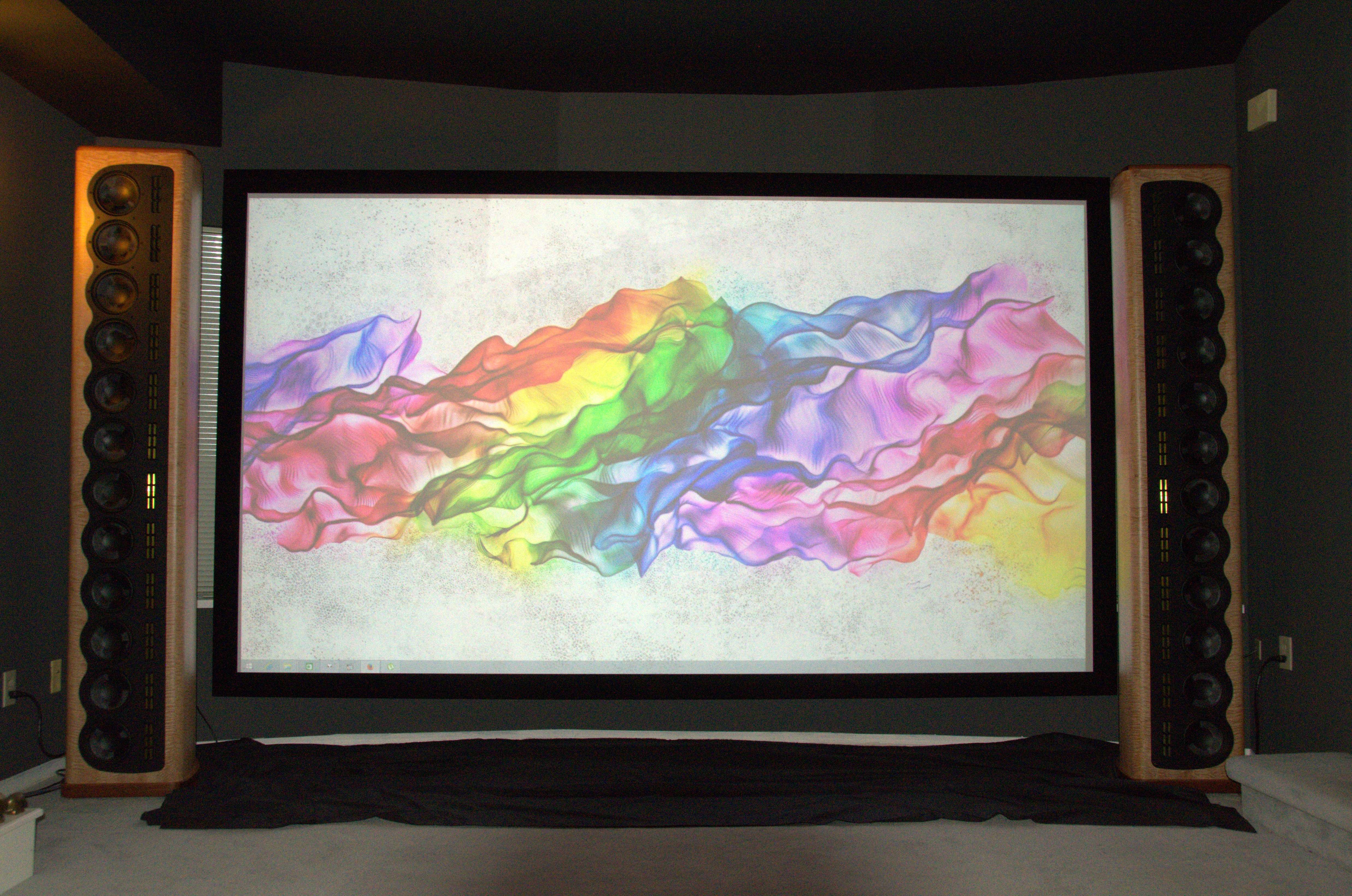

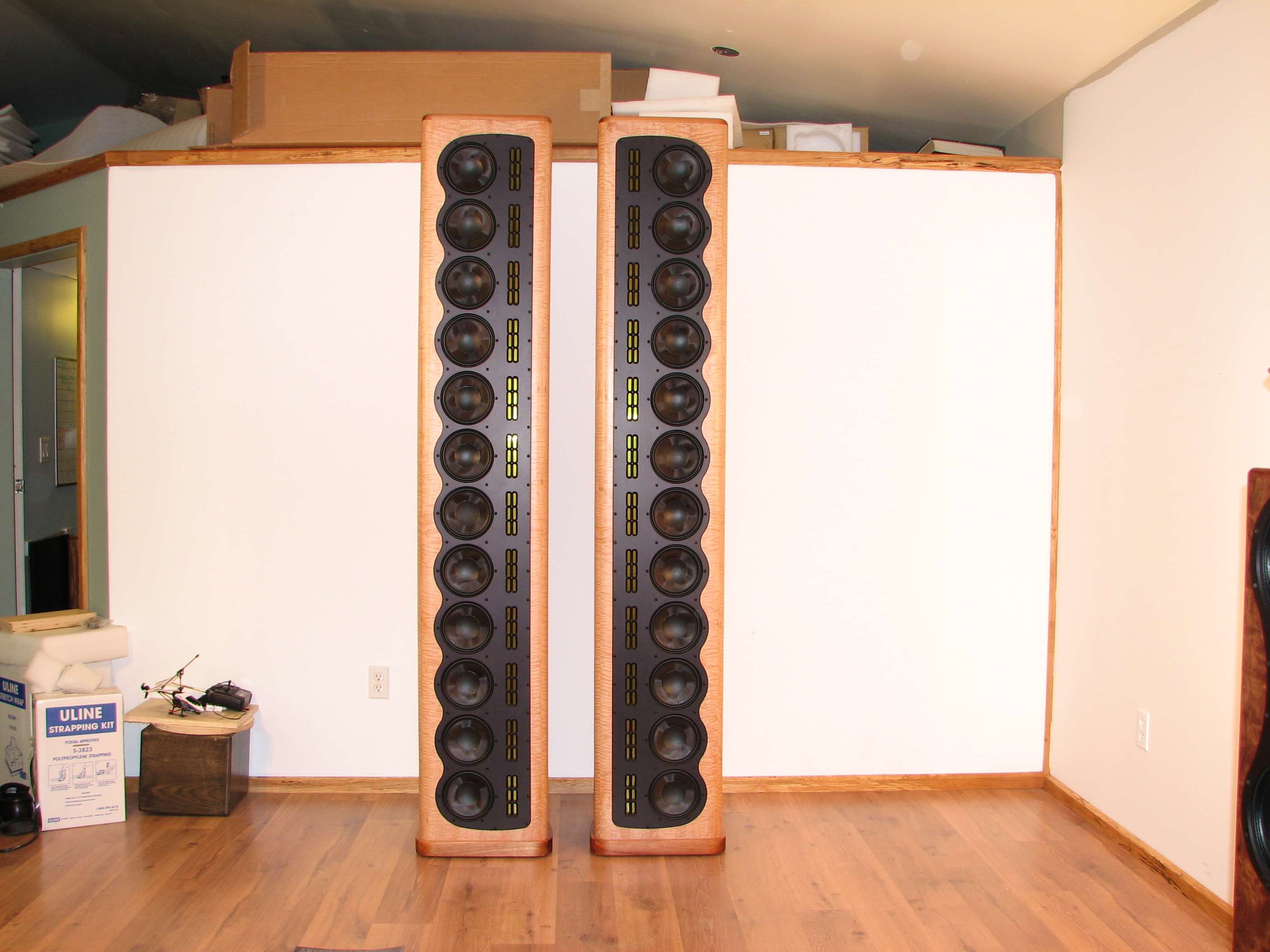

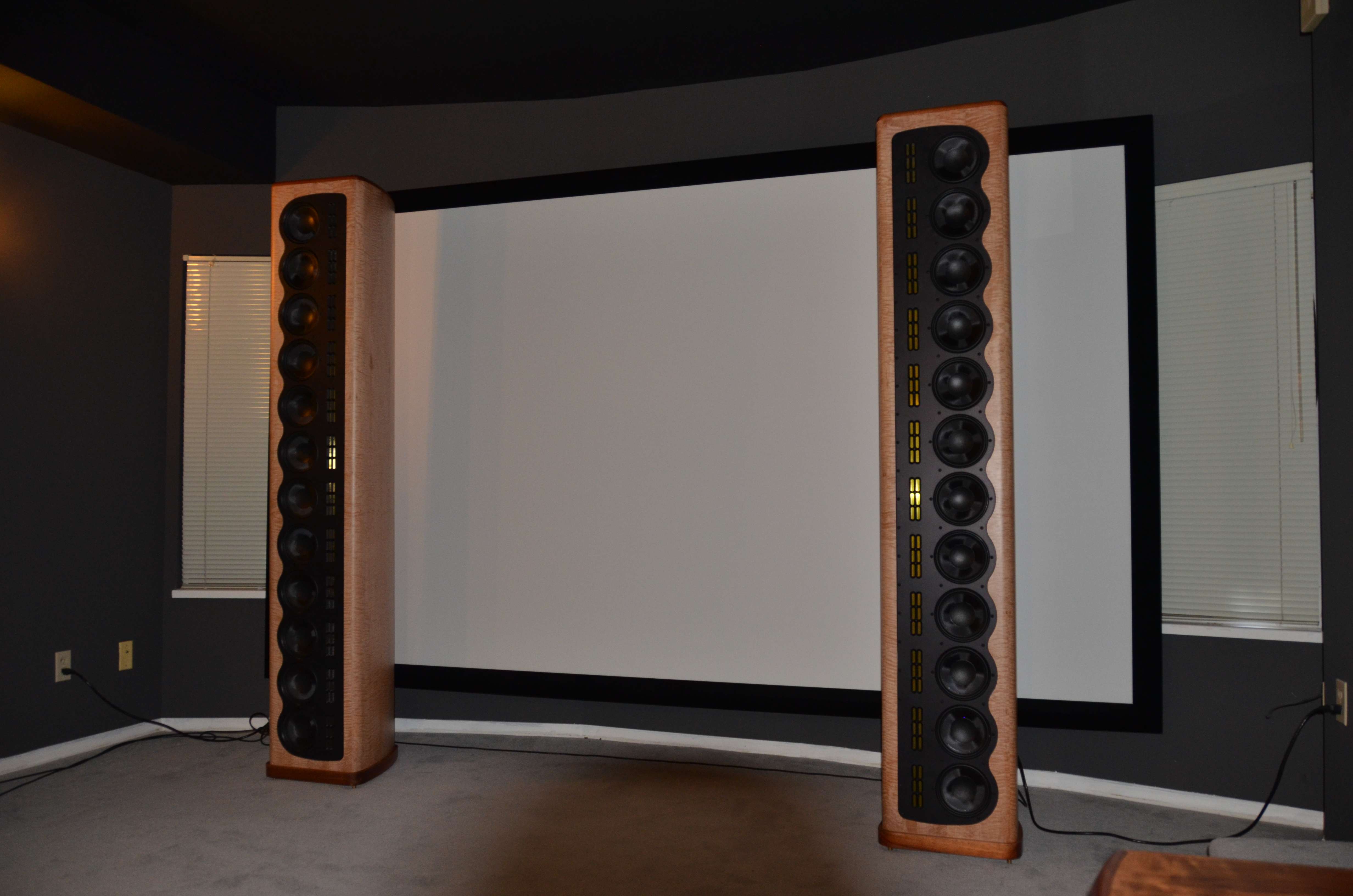

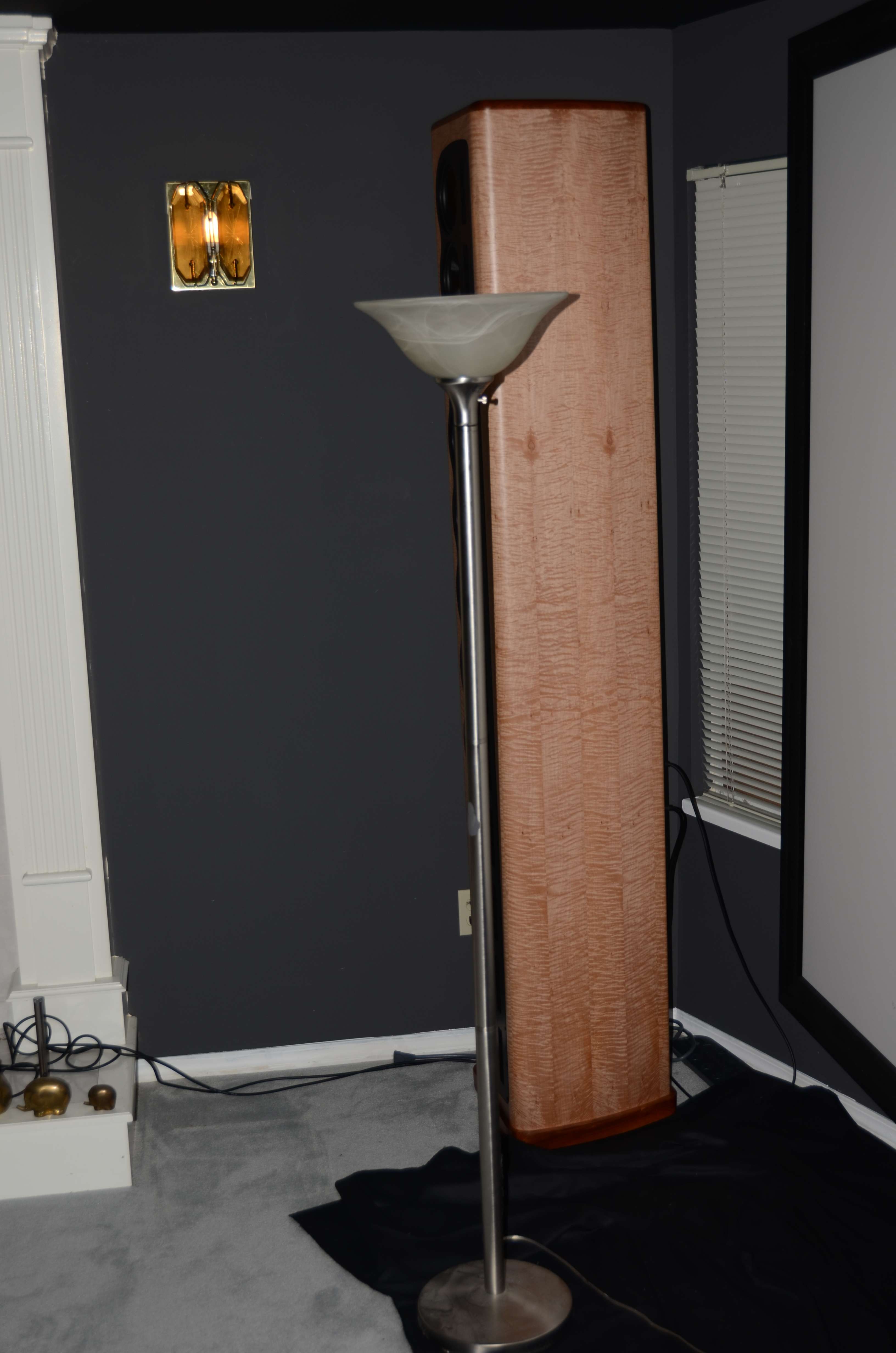

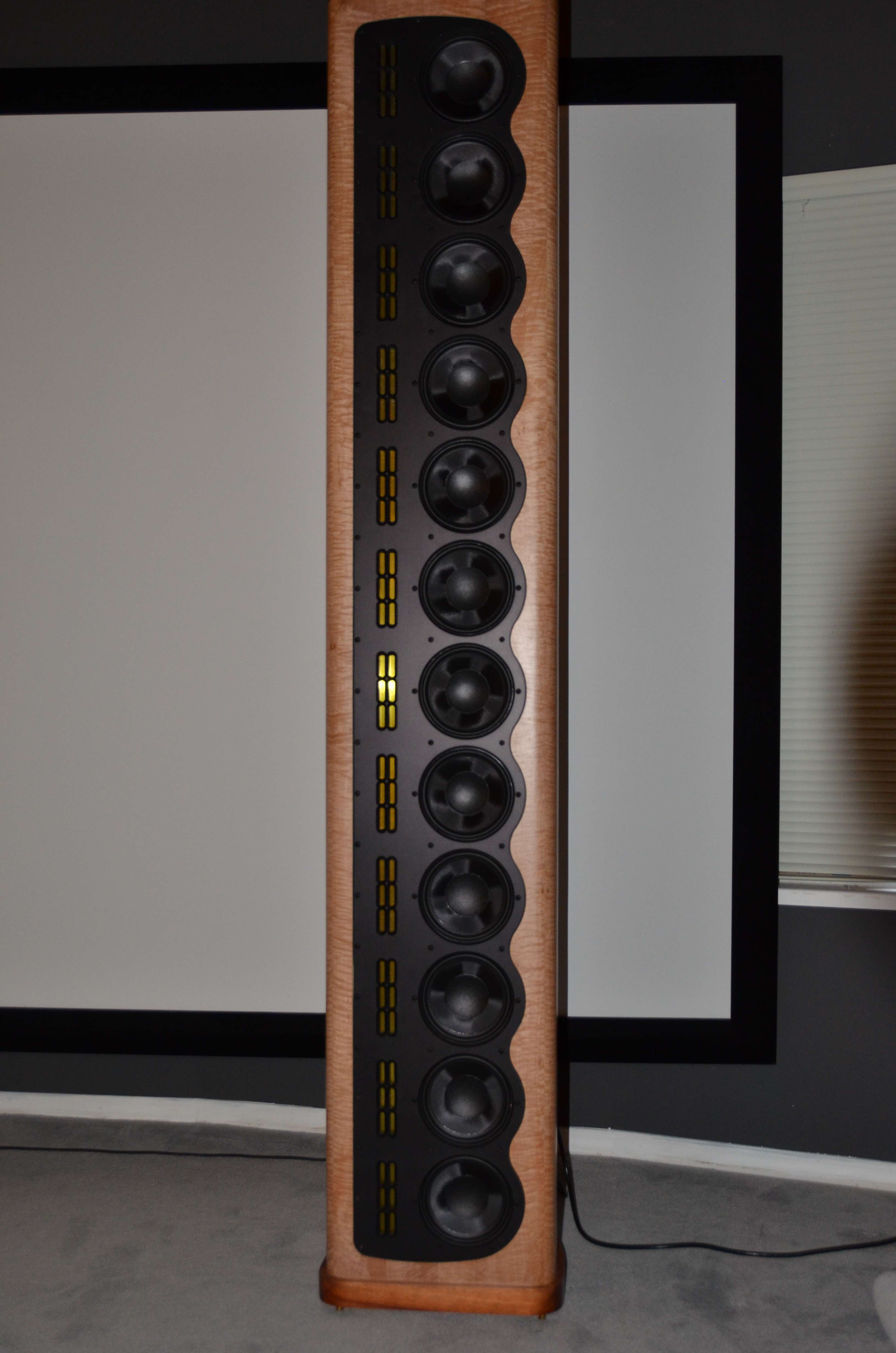

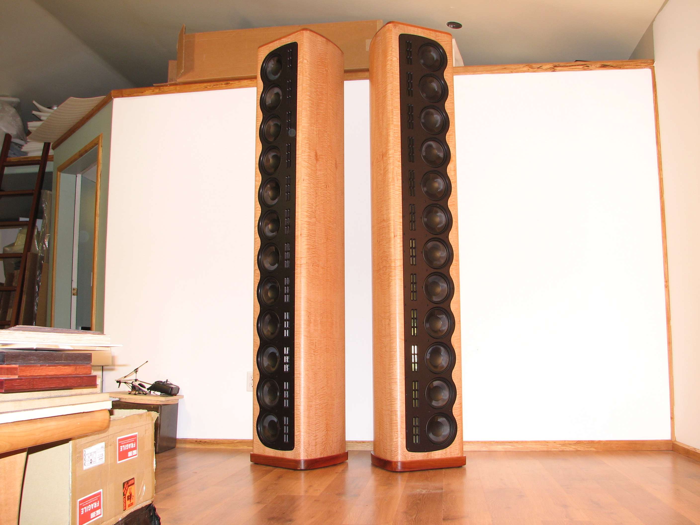

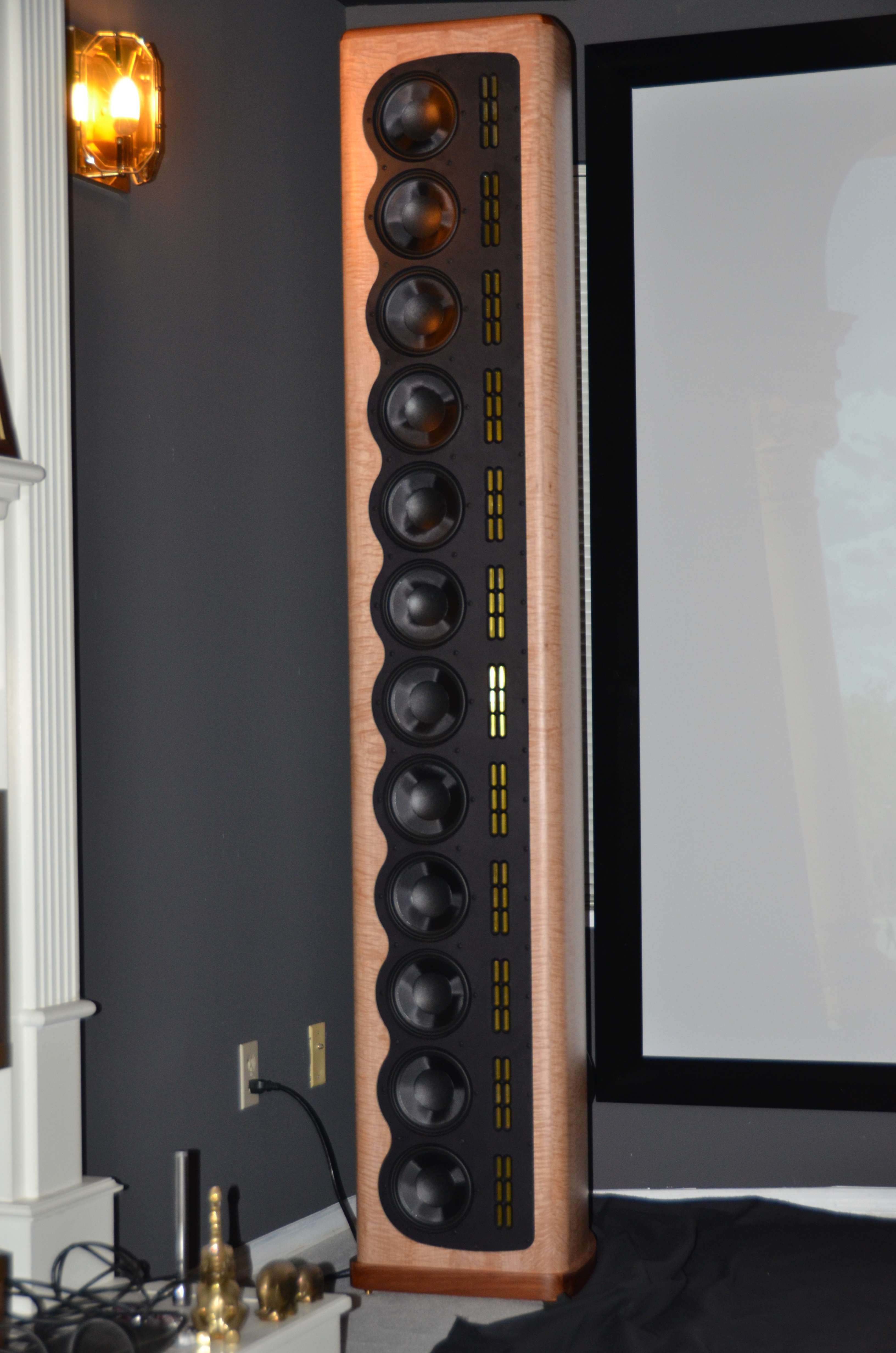

The Arrays being 85” tall or 7’-1” made me look small. They are certainly impressive to look at. The Maple veneer is finished beautifully and produces an attractive chatoyance if the room is lit up. The Koa Veneer ties everything together like a set. The subwoofer is not much larger than my Velodyne Subwoofer. Definitely not as large as you would you would think. But it definitely is heavier at around 175 – 180 Pounds. The Koa on it is certainly very nice and has its own chatoyance. Moving the Line Arrays and Subwoofer by yourself is definitely is a bad idea. The impression when they first came in was… “Will these fit?” They certainly look much larger in person.

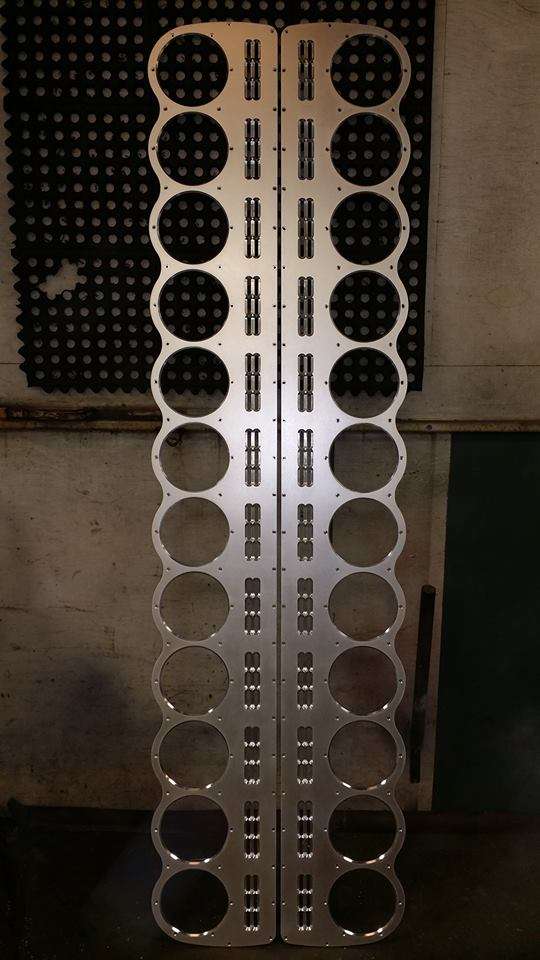

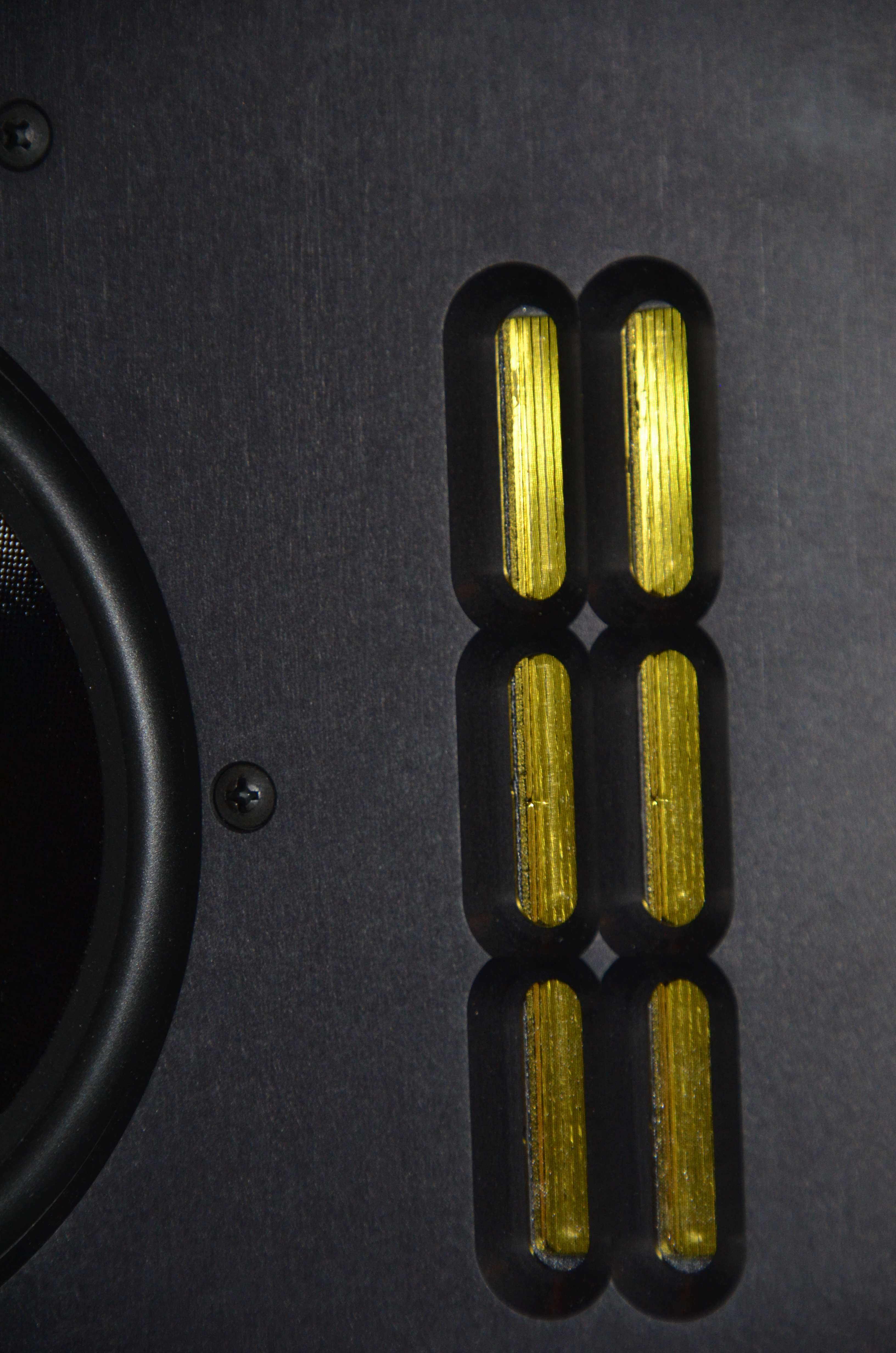

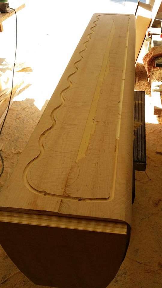

The Faceplate is beautiful with a wavy design. It finished beautifully along with the Custom Amp plate in the rear. It certainly looks very professional.
Imaging:
The speakers were positioned away from the wall and closer together for the optimal imaging. Other qualities of the sound such as Dynamics SPL, Detail and clarity was not noticeably effected during music playback at different placements. Although not as good as were Nathan had it at his place due to my more limited placement and time for optimizations. It is, however, quite close. With further tweaking would result similar performance in imaging. Distortion is also slightly lower in Nathan's although may not be audible.
The Line arrays had sharp imaging, Just like the 6.1P. The soundstage is enormous and has an enormous amount of depth when asked of it. The way it reproduces it is very realistic. These speakers do not have a small sweet spot. It has an enormous one. Sonically, the line arrays sound very similar throughout the room due to its very wide dispersion. The voices produced are accurate and pinpoint along with any other effect.

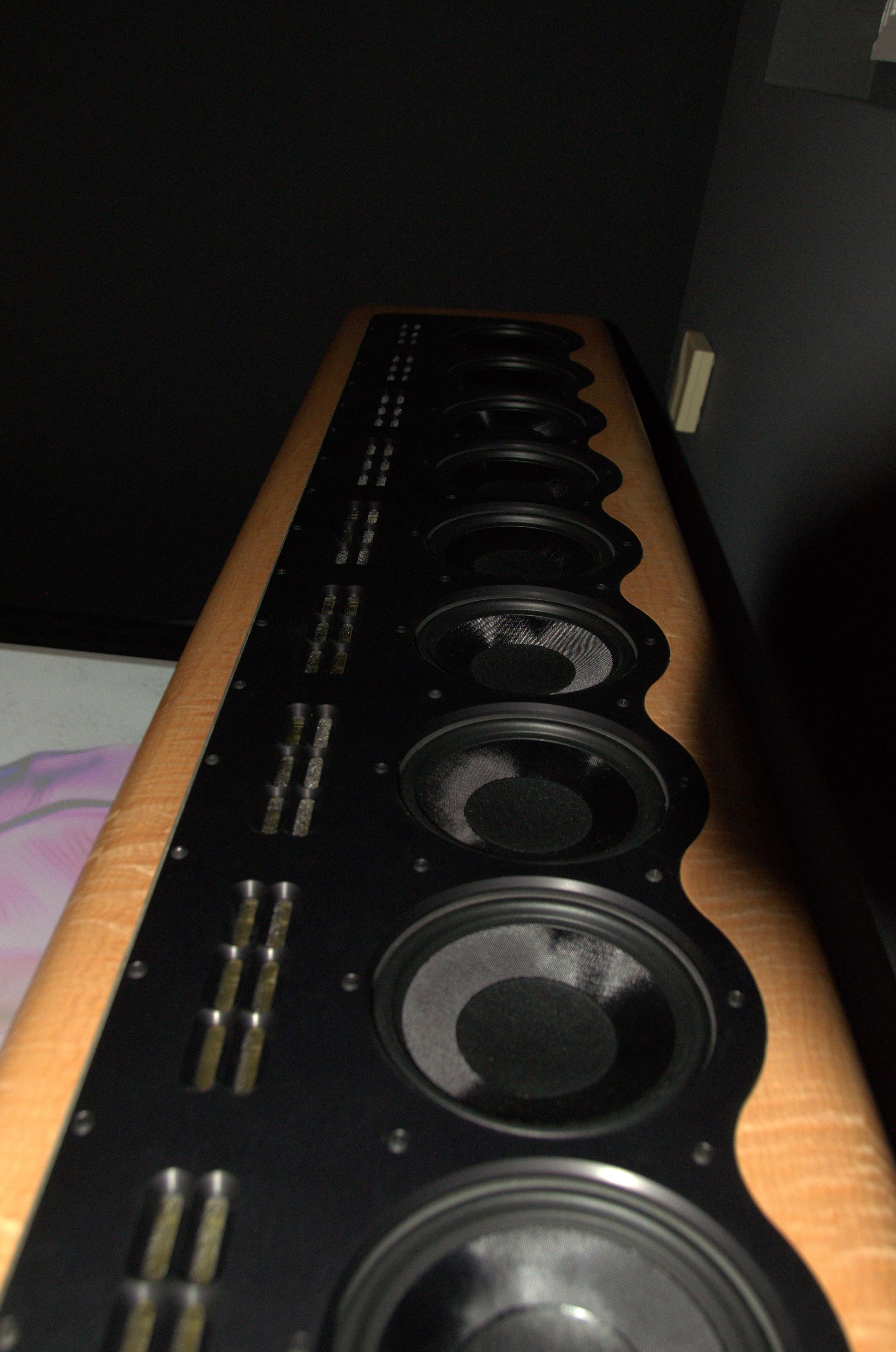

The woofers are integrated very nicely with the Planars. I did not any distortion what so ever. The details produced is quite phenomenal, violin, piano and all its harmonics/resonance are produced with great detail. It sounds like a real piano. Anyone that has played a piano would know what I mean. Detail is the last thing you worry about. The subwoofer is capable to reproducing all the little details within it frequency range with very little distortion at a very high SPL.

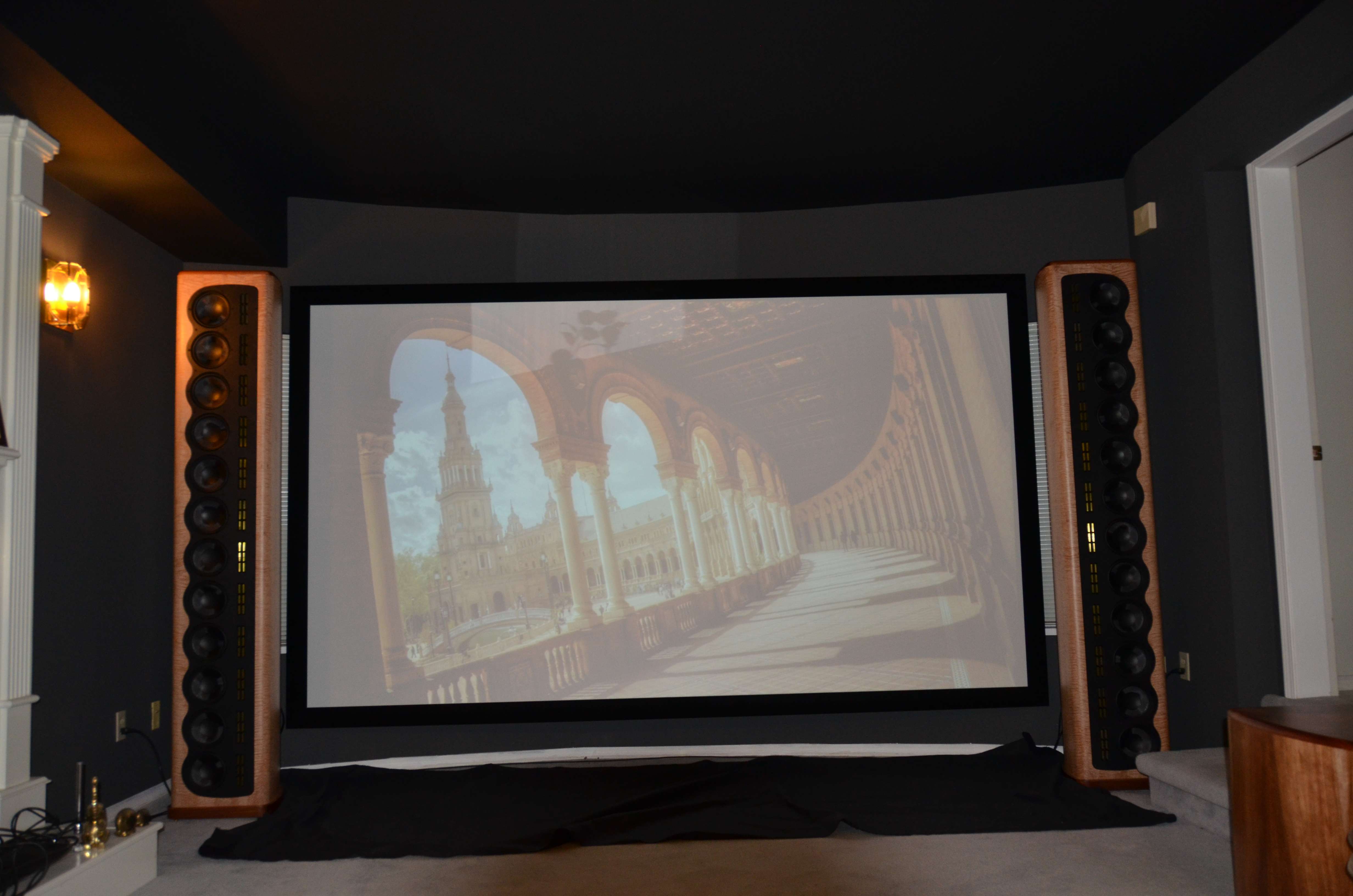

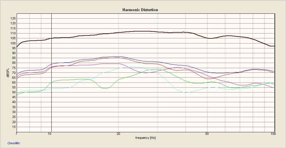

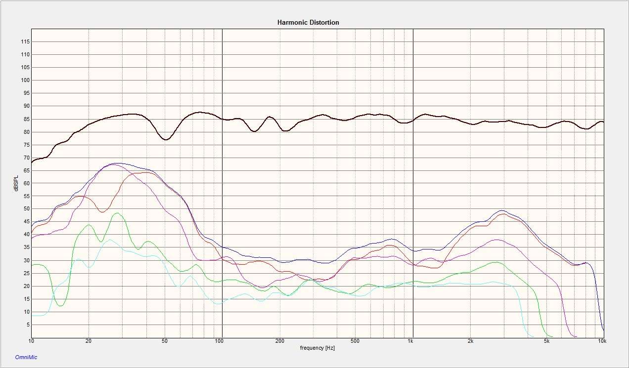

Distortion Charts
Distortion at listening position in my room is in the 2nd and 3rd Photos
Distortion at the lowest point is about 0.17%
At it's highest point for the line arrays is about 1.77%
100hz to 2Khz is no higher than 0.562% Distortion
Distortion on the subwoofer is an average of about 1.77% to 5.6% THD
Nathan has better distortion figures because of less interaction and better positioning.
One Line Array in Nathan's Room 15 degrees off axis EQed Distortion in 7000 Cubic Feet Room about 4 Meters. - These Arrays are NOT designed in the first place for bass extension since I am using a subwoofer.
Line Array Pair Distortion (Crossover is at 100hz)
Distance from the Line Arrays to my head (listening position) is about 15’-2”
Subwoofer (Funk Audio 18.2) is located about 10’ away (Crossover is at 100Hz)
