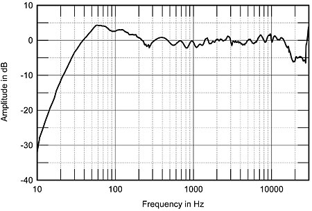

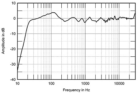

Well the bass region is significantly affected by the room. So the bass "hump" appears to be very common. You can see this bass hump (around 130Hz) even with the $22,000 Revel Salon2 and probably most speakers.
http://www.stereophile.com/content/revel-ultima-salon2-loudspeaker-measurements
The equally excellent $20,000 KEF Reference 207/2 has the "bass hump" at ~ 60Hz.
http://www.stereophile.com/content/kef-reference-2072-loudspeaker-measurements

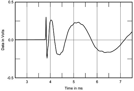

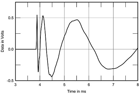

I'm sorry but I respectfully disagree. I think it is a design issue.
The KEF frequency response.
Kef impulse response, off the graph!
Revel Salon 2 Frequency response.
Revel Salon 2 impulse response. Again off the graph, but about 7 to 8 msec
The ascend impulse extends to 4 msec, so better.

I don't think these bass humps (Salon2, KEF 207/2, Sierra, etc.) mean that the Q-values are high or the bass is muddy in any way.
You're generalizing too much, and forcing broad conclusions that really can't be made. I think you do know better. I only said peaks in this bass range suggests high Q. It doesn't prove it.
There clearly are other room-related reasons why a frequency response curve can have the appearance of bass peaks. It depends on the details of how the frequency response curve was measured.
I think there is a good reason why we don't see too many measurement of the Philharmonic or Salk speakers below 200Hz. I bet you would see a bass hump between 60-130Hz too.
Are you really suggesting that Philharmonic or Salk speakers are designed with high Q bass peaks? Or are you playing Devil's Advocate?
Dennis doesn't show frequency response measurements below 200 Hz because he doesn't have an anechoic room, or the capacity that Stereophile has to simulate one. He readily admits that, and I think that's being honest.
I actually am putting almost all the weight on the impulse responses, which suggest that the frequency responses are likely correct.
Of those speakers mine is the only low Q speaker of the bunch. The others are high Q, which from the design is what you would expect.
