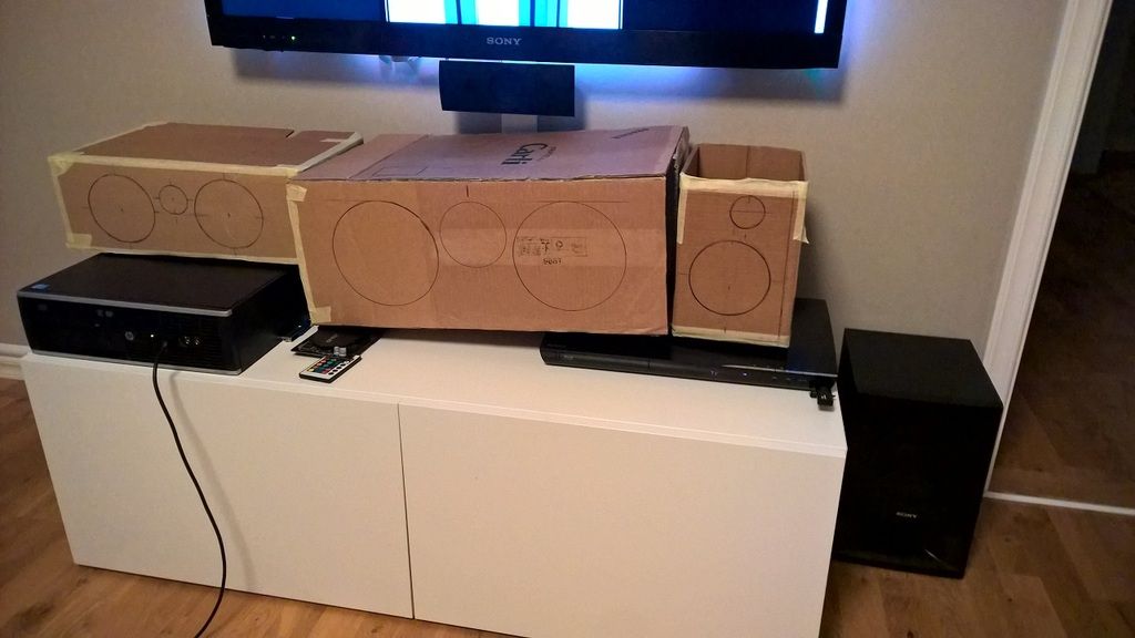

today I made some speaker test ro understand how big they are, as you cam in the picture, left os mtm, center blues mtm and right os tm. Impressive how big is the blue!
looks that the OS speaker will fit better in my room, and the blues look a little bit oversize :(

Instead of painting the cone, how about cloth covered grilles?
MrBoat
I think the Blues are 4ohm. Will your AVR handle a 4 ohm speaker? The Blues MTM is 8 ohm but the TM is 4 ohm.

grilles will be made at the same time, paint is just something extra in my mind
the avr-x1300 is rated 4 to 16 ohm, but i will double check if the european version is limited to 6. there are a lot of av receiver that have different spec from us to eu market.
